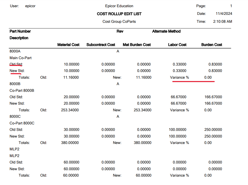

I need help with Creating Variance Calculation Field in Part Application using the Old/New Standard Fields
Hi everyone! I’m looking to create a variance calculation field in the Part application. The variance is displayed directly in the Costing Workbench report as the difference between the old standard and new standard, but I couldn’t find any database fields named ‘variance’ or anything related to the old and new standards. Does anyone know how I could achieve this? I’ve attached a screenshot of the report where the variance is auto-calculated and displayed. Any tips on how to track down where this calculation happens in the system?

Hi, I don’t want to edit the report itself. I just want to create something that will display the variance within the Part application. I’m having trouble figuring out how to achieve this. From what I’ve seen, there isn’t a field that stores variance; it’s calculated as a difference using multiple fields. I want to display only the variance field within any part. Do you have any ideas on how to do this?
