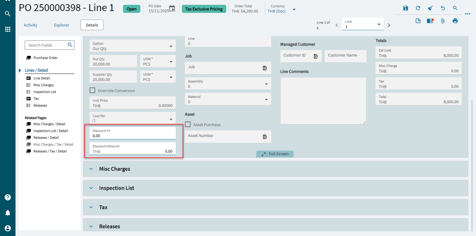

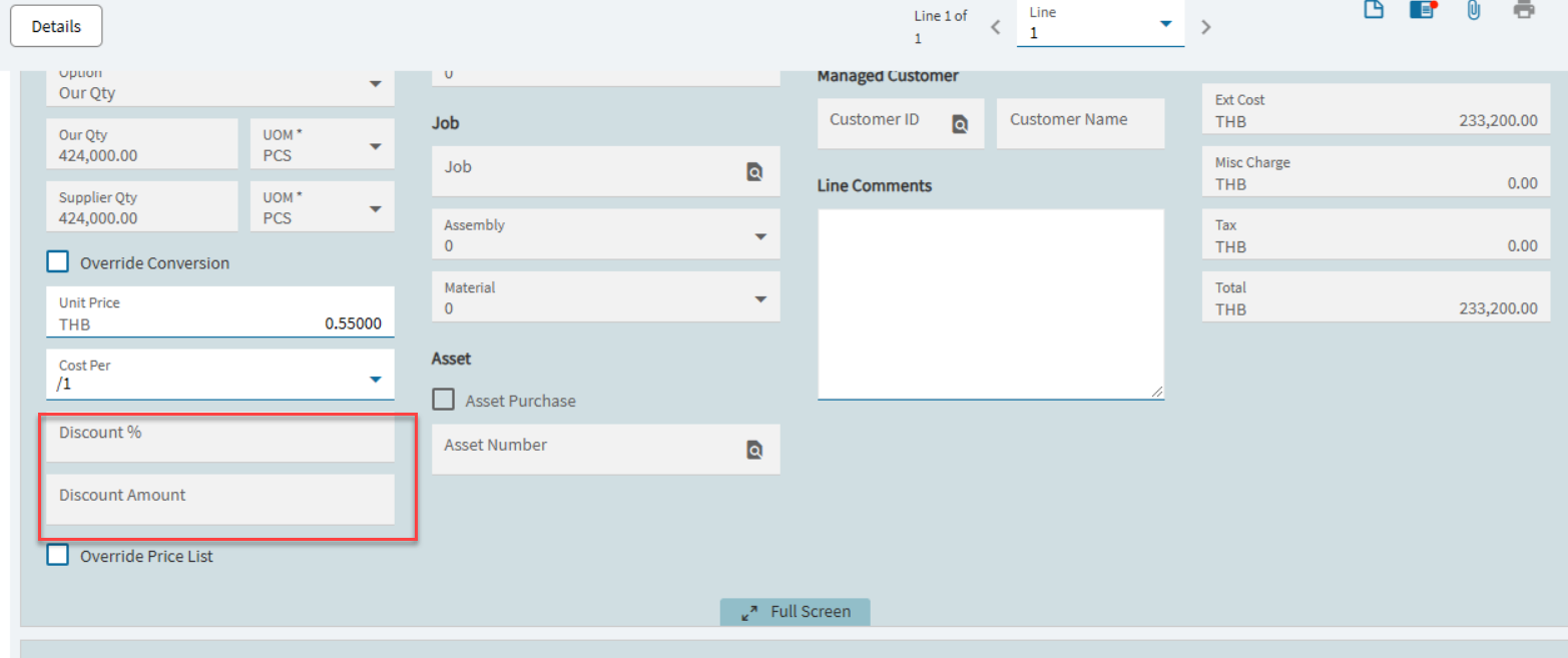

I need to add a discount to the Line Purchase Order (PO) page for Standard purchases

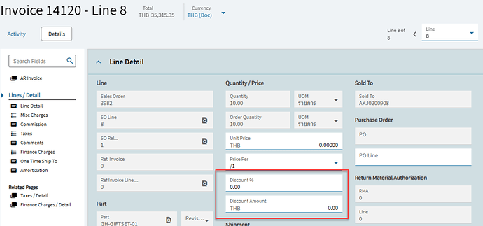

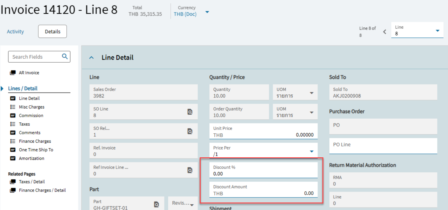

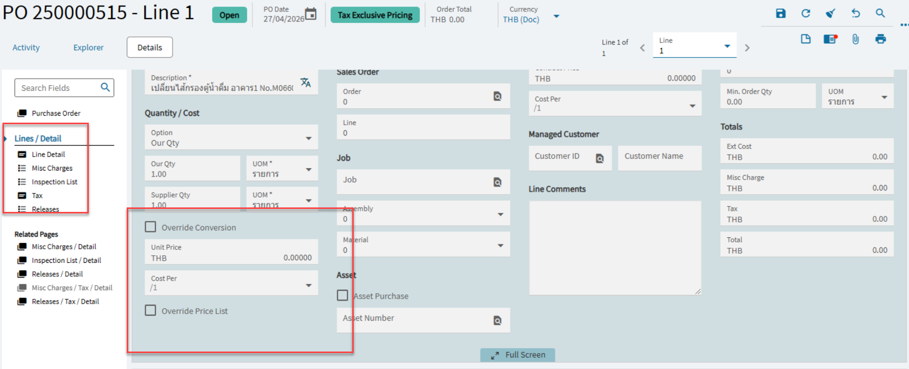

Help me! I need to add a discount to the Line Purchase Order (PO) page for Standard purchases. It’s not there, unlike the AR Invoice. Is there a way to add it? Thank you for your help.
Purchase Order
AR Invoice

I’m missing something about what you are looking to do. You’ve highlighted identical fields in AR Invoice and PO Entry.
The original Line Detail section didn’t have a way to enter discounts, but I want to add the ability to enter both percentage and amount discounts, similar to the ARinvoice page. Is there a way to do this?

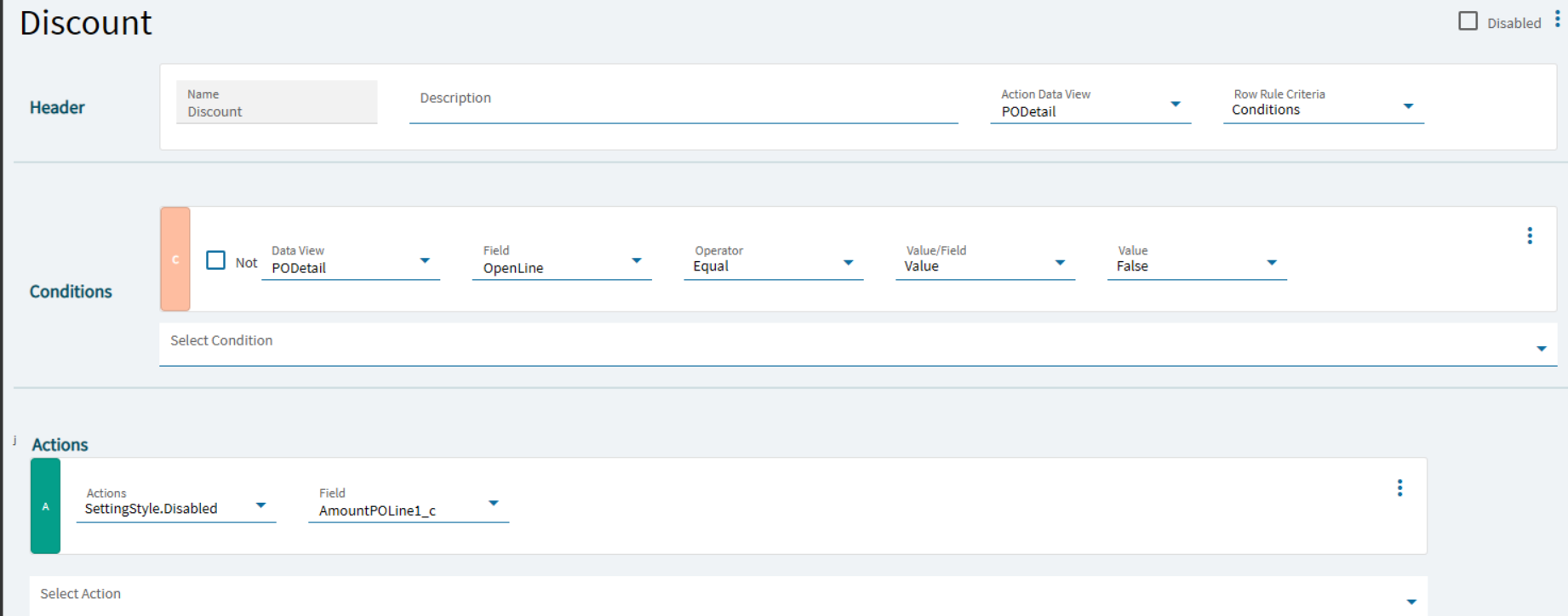

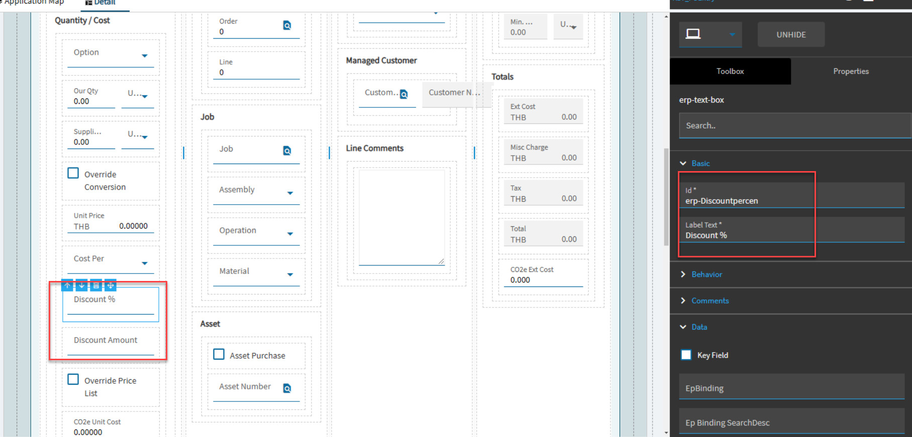

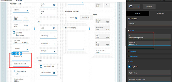

I’ve added a channel to AppStudio. What do I do next?

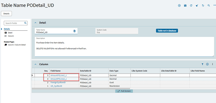

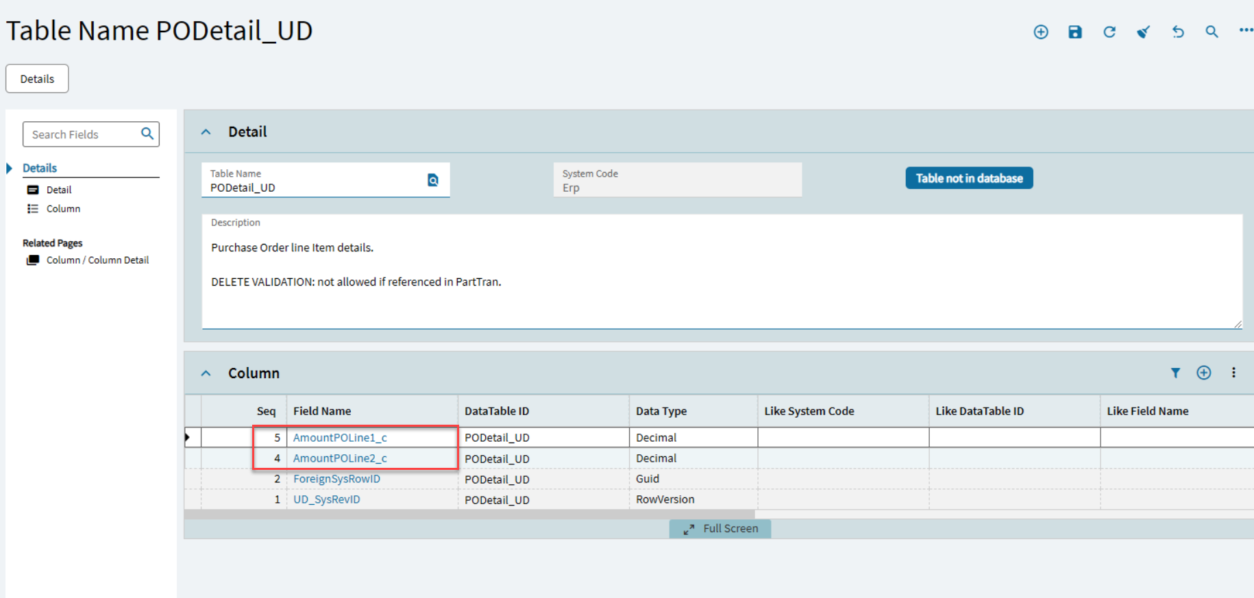

And I have successfully created the UD column.

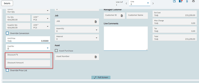

I’ve created a field for entering data, but why is the field still closed and preventing data entry?

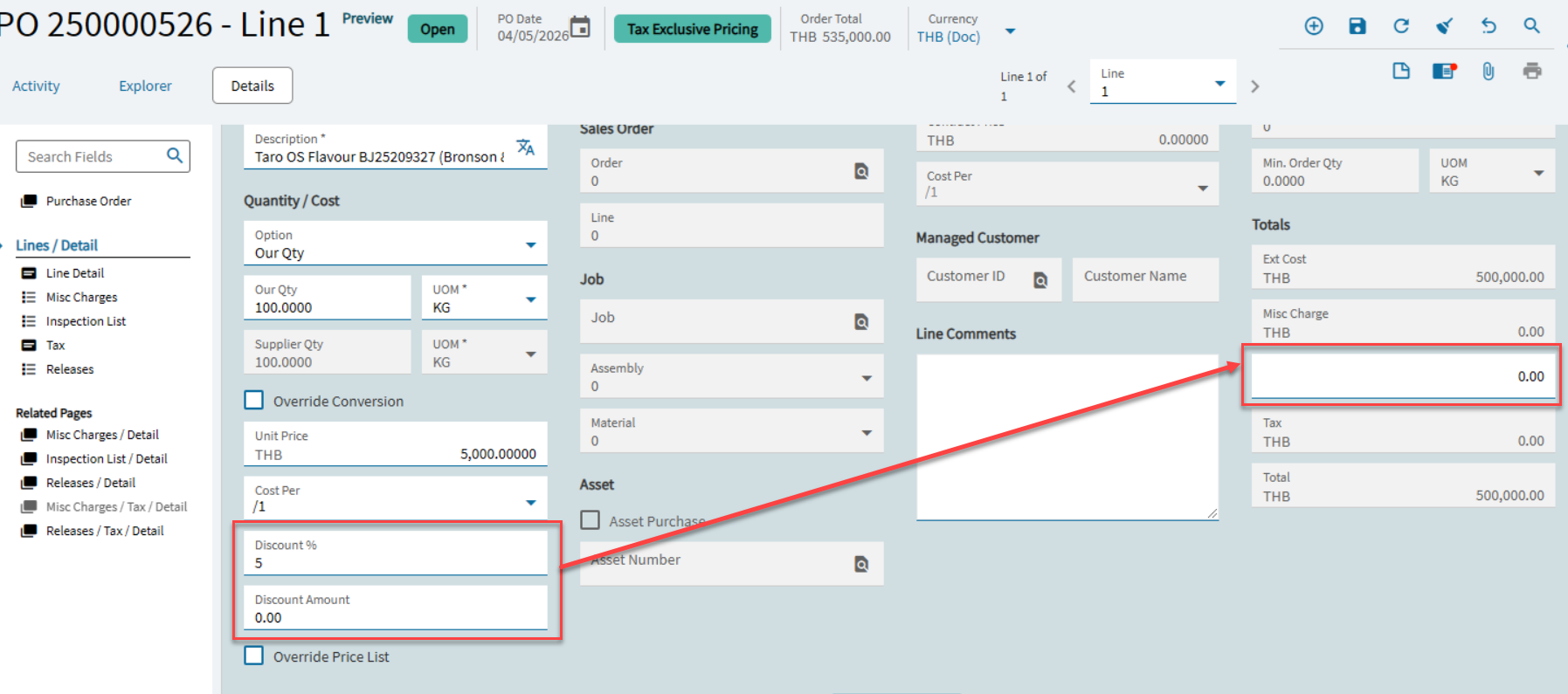

I’ve managed to do it, but how do I put the total discount amount into the sum column? Does anyone know how?
