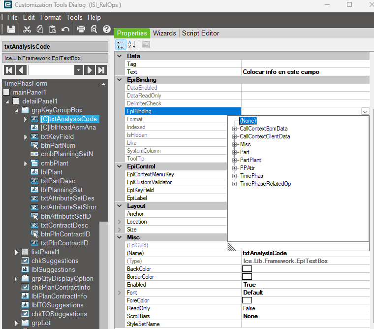

I need to add the information that the Part.AnalysisCode field brings, but when searching for it in EpiBinding I cannot find that field, what can I do to be able to see it or if it is necessary to create a custom or BPM

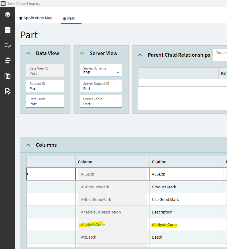

Apologies, I don’t know classic customizations very well, but your image is showing the available dataviews, correct? Can you expand the “Part” dataview and see if AnalysisCode is in there as an option?
The field I need does not come (AnalysisCode)
Sorry, I cannot get back to the Classic version of Time Phase to explore it. I know it available in the DataView in my current version.

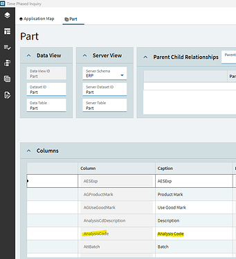

It’s not available in the classic form, at least in my version:
Looks like it only pulls in a small select set of variables.

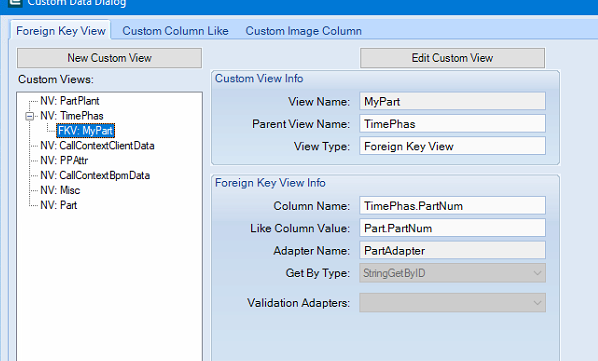

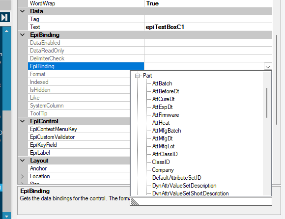

I added a Foreign Key View to get Part data.
oops, How can i get that form?
Search here or EpicCare for Foreign Key View and you should find the steps to add a FKV. You want it to look like the image I posted and then MyPart will be available as a binding view.
