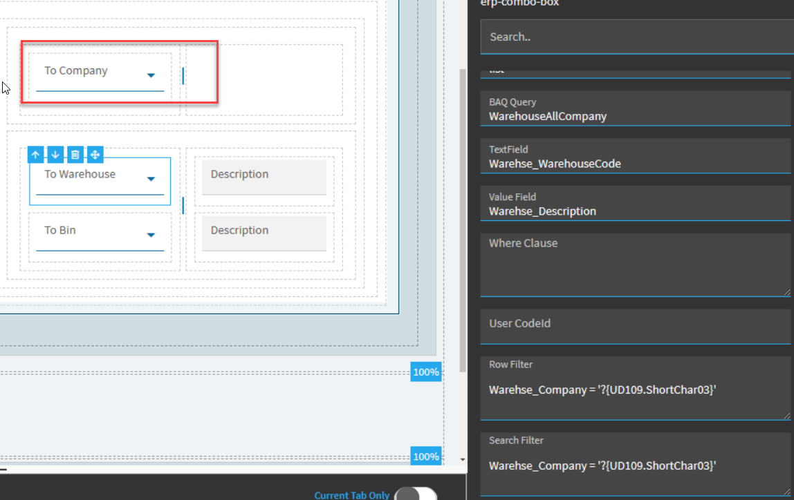

I want to filter warehouses from the BAQ list, but I can't. What am I doing wrong? Please help
I want to filter warehouses from the BAQ list, but I can’t. What am I doing wrong? Please help.
Did you mean to filter by Warehse_Company? It seems like an odd filter.
What behaviour do you get with it setup that way? Do you get all BAQ rows, or no rows at all?
I want to filter warehouses from a specific company, but due to the BAQ ,
I’m pulling data for all warehouses from every company, but in the image, it shows “all.”
From what I recall way back.in the day, warehouse names aren’t unique if you have multi-site or multi-company setup. I think you had to pair it with the site name.
My purpose is to create a multi-company, so I would use BAQ.
