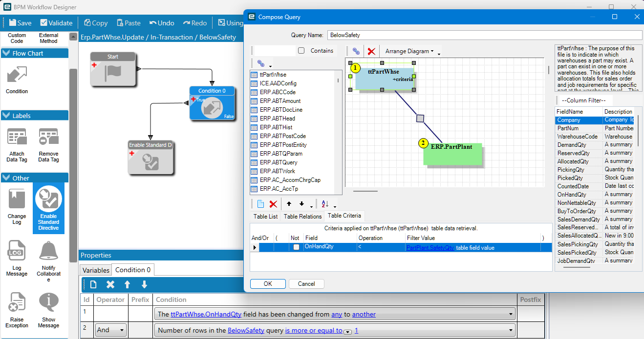

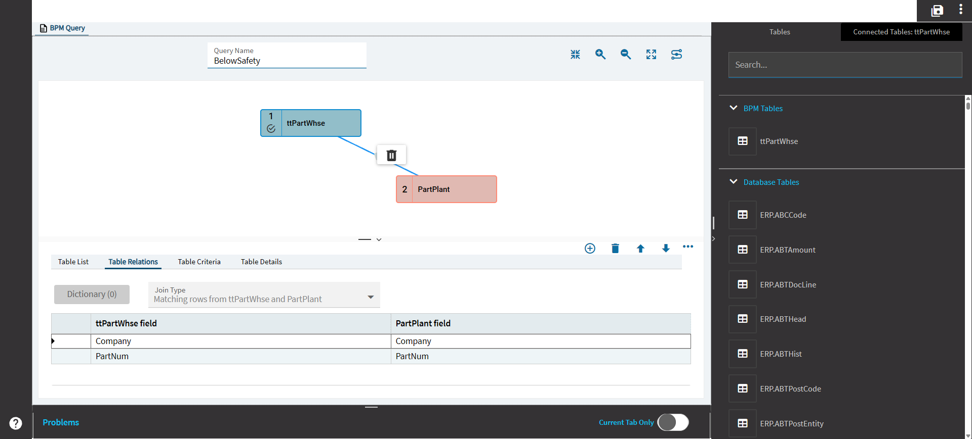

Is it like this?

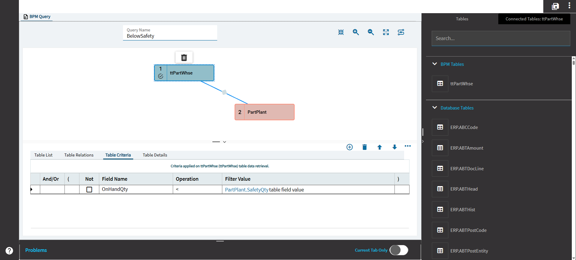

You can try this as a starting point. It’s an in-transaction to check when the on-hands go below safety, then enables a standard directive to send the email.
:ring_buoy:I’ve put about 30 seconds of thought into this so “starting point” is the key phrase here. At the very least you should move it to be a method directive.
This might work fine according to your post, but there are some “ifs, ands, or buts” that come with it. An example is that you would want to check if the on hand qty was already below safety before firing this, or else you may get multiple emails for the same part.

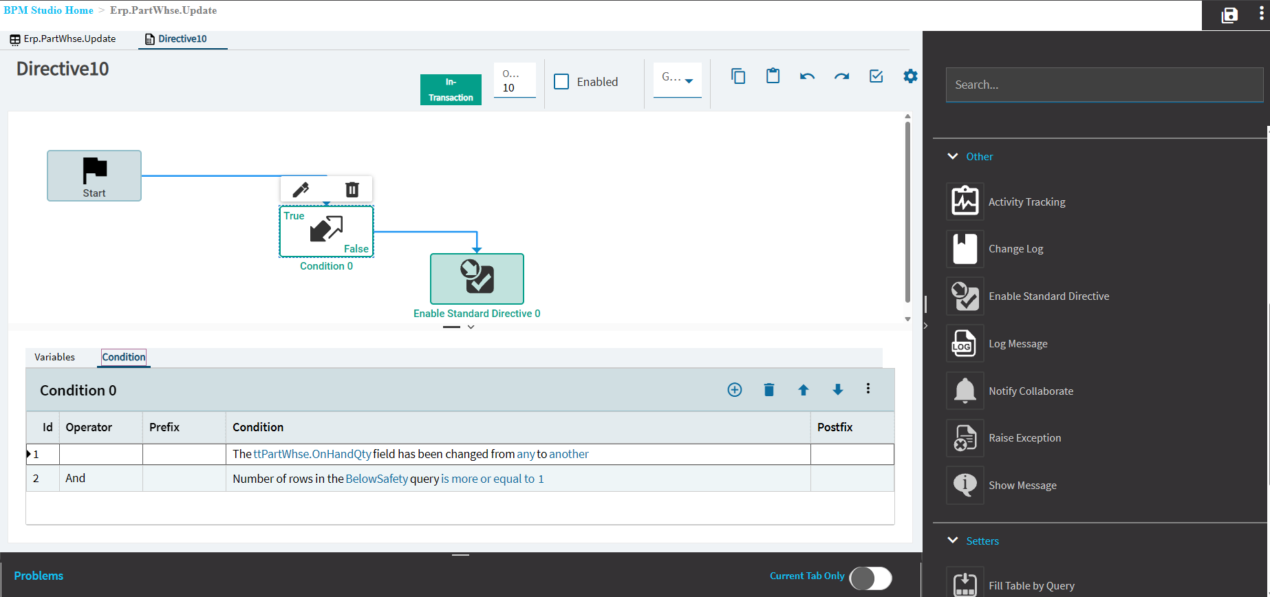

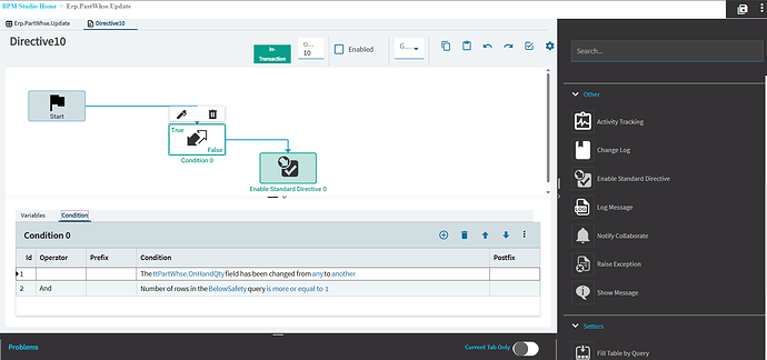

Is this correct? And how can I send notifications when the stock level falls below the safety level?
make a standard directive. Put a condition that it has been enabled from the in-transaction directive. Use the send email widget in the standard directive.
