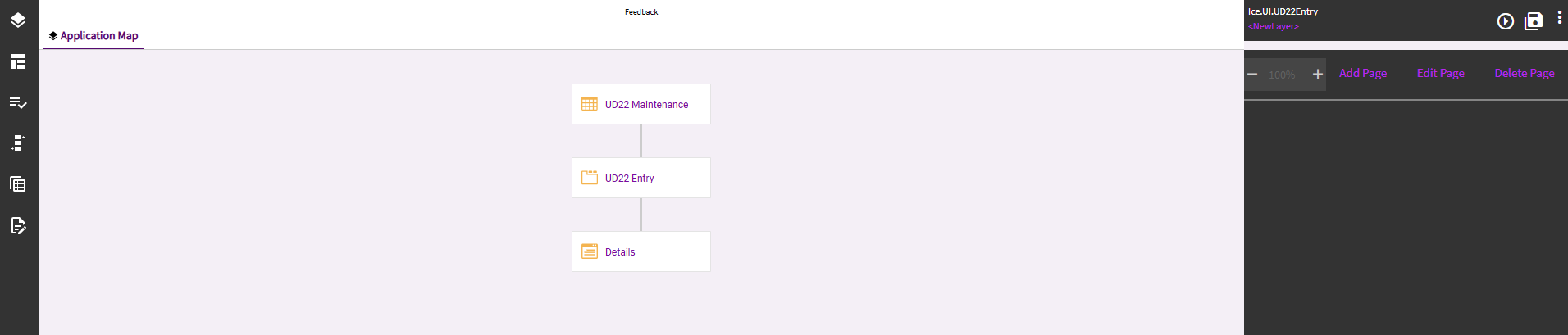

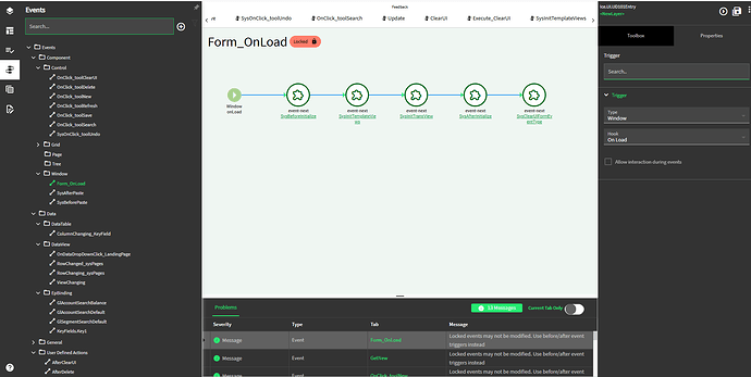

You don’t need to “create” a form for UD22. It already exists. Just search for it in App Studio.
It is pre-built with a structure:

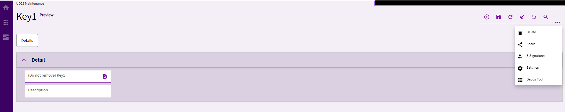

If you create a layer and preview… the Save and Delete options are already there:
But… if you manually create a dashboard or application from scratch… then the events don’t exist. Epicor does not know what BO’s you’re going to be trying to save/update/delete… so they can’t pre-build that.

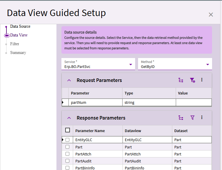

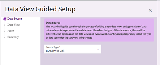

What you CAN do… if you build your dashboard / app from scratch is utilize the DataView wizards.
Use the Guided Set Up and choose BO Service Call as the Source Type:
Choose the BO you want to access via your dashboard (i used Partsvc in this example):

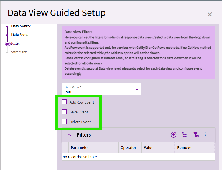

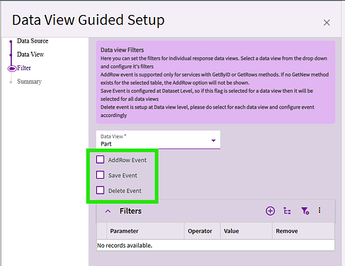

You choose the views you want to add to your dashboard and guess what… the wizard asks you if you want to create Add, Save, and Delete events:
The tools are there. You just need to be willing to fill the gaps.

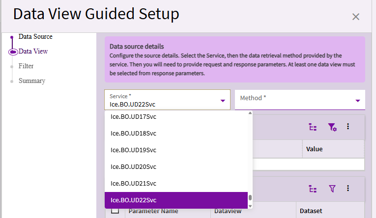

And yes… you can do the same thing using Ice.BO.UD22Svc
