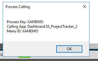

Here’s my code on button click:
string projectID;
_txtProjectID = (EpiTextBox)csm.GetNativeControlReference("19665c97-7209-4997-a03f-0dd3e3f7b052");
projectID = _txtProjectID.Text;
ProcessCaller.LaunchForm(oTrans, "XAMEMO", new LaunchFormOptions
	IsModal = false,
	ValueIn = projectID
I get this message since I’m in debug mode:
![image](https://epiusers.help/uploads/default/original/2X/b/be3dca3bc7d49e72a618737a9582dc85f1d4c421.png)
Problem is that nothing happens after than, no memo form…
Should I put a .dll instead of XAMEMO in the 2nd parameter of LaunchForm? I onced manage to open buld project analysis with this code but there’s a dll instead. If so, how can i find the dll of the project memo form?

Thanks but I’ve been testing your code in the upper section and I can’t make it work on a button click.
Also, if I just want to add the option in the toolbar, not sure what the Key1 is supposed to be in your DataRow. Should I put Project\_ProjectID from my view and in my second parameter I put “Project:” so I can open the memo editor for the project?

> [@hkeric.wci](#):
> this.LaunchMemoEditor(dr[“Key1”].ToString(), “UD100:”);
Sorry but I still can’t get it working. Any way to call the LaunchMemoEditor on button click? Nothing opens when I do this: this.LaunchMemoEditor(projectID, “Project:”);
