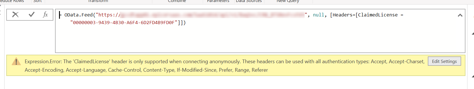

We recently purchased the Webservice license and are trying to implement with our Excel workbooks using oData feed data sources (v1 REST API using Basic authentication)

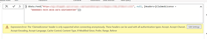

When I include the ClaimedLicense in the header, I get this error:
The ‘ClaimedLicense’ header is only supported when connecting anonymously.
Does anyone have a workaround or solution for this?

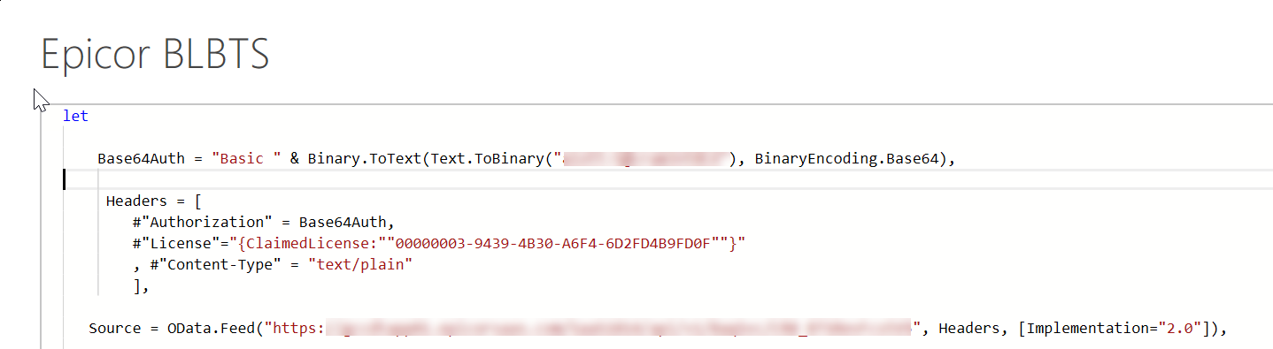

Or might be like this as I have never used the Webservice license, so I’m guessing based on Mark’s documentation provided:
let
    Headers = [
          #"Authorization"="Basic " & p("Base64Auth")
        , #"License"="{ClaimedLicense:""00000000-0000-0000-0000-000000000000""}"
        , #"Content-Type" = "text/plain"
   DataFeed = OData.Feed("{FEED}", Headers, [Implementation = "2.0"])
in
   DataFeed

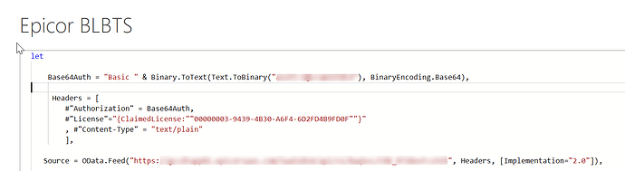

That worked…thanks Clint and Mark!!
Here was my final statement:
