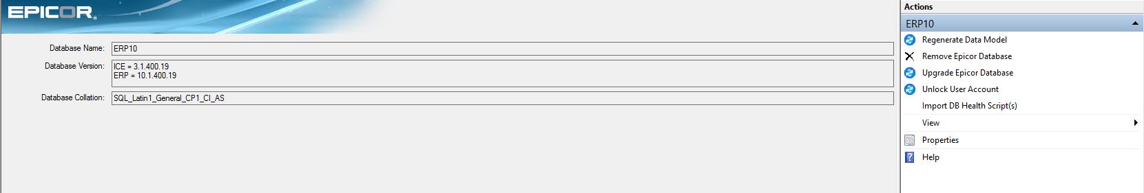

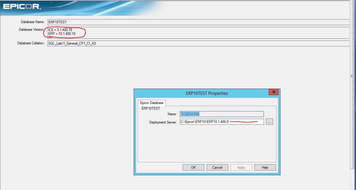

This morning I was doing an fix for the Min Max Safety issues I noticed. And I told Epicor help that my system was 10.1.400.19, and in fact, under help, that is what it says. However, I got an error that said, can’t apply the fix 10.1.400.19 to a 10.1.400.0.

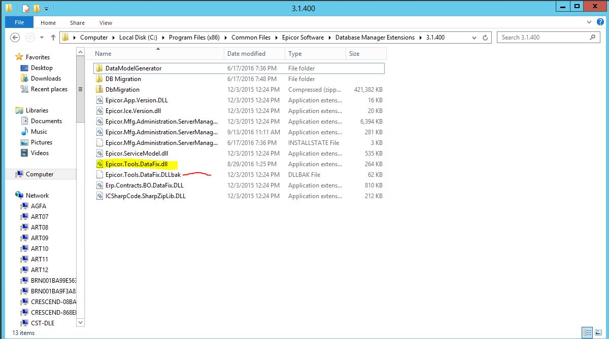

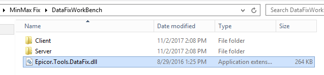

In the zip file that comes with our health checker there is an assembly that must be copied to “C:\Program Files (x86)\Common Files\Epicor Software\Database Manager Extensions\3.1.X00\Epicor.Tools.DataFix.DLL” on before the import of the .DF file (where 3.1.X00 is the release you’re on). Not using the .dll with the particular heath checker/data fix before import can cause an error like this.
@aidacra My menu path is C:\Program Files (x86)\Common Files\Epicor Software\Database Manager Extensions\3.1.400
I had a tech do a webex to verify everything and we even redid everything and go the same error. The tech was very confused. And the original guy helping me is probably pulling his hair out because he keeps telling me to use the files, and I’m like, yeah, that’s what we did.
So would the fact that my file path doesn’t state 3.1.400.19 cause an issue if my system is 10.1.400.19?

I have a 10.1.400.14 database (otherwise, all other dbs I have access to are 10.1.400.25+) and it was successful against that. All I did was replace the existing Epicor.Tools.DataFix.dll
with the one in the data fix .zip file
restarted my EAC, and it imported without issue :confused:

@aidacra Well, I had to open the Admin Console, then put the dll in, then restart the console. That worked. Don’t know why, but if I did it any other way, it just wouldn’t work.
