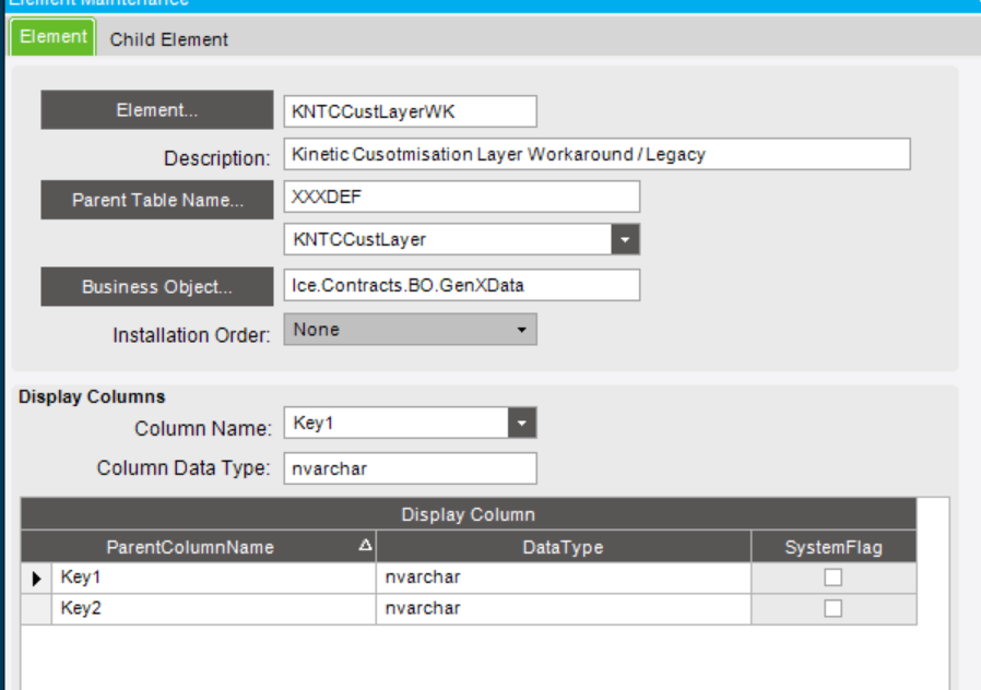

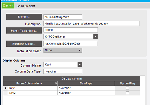

The workaround that I devised for our technical team is to create a new Solution Workbench Element that replicates the functionality of moving Kinetic layers in solution workbench from 2025.1.
In 2025.2 they changed the Solution Workbench to use the same functionality that Application Studio Import / Export uses which is why they both have the same issue.
This workaround puts it back to 2025.1’s way of moving the raw record in XXXDEF. This is only needed on systems you are creating solutions from.
Open Solution Element Entry (note, only available in classic. Support case raised)
Create a new Element as per the below. You can add more Display columns if desired.
Key1 is the Layer Name and Key 2 is the Application Name
Then choose this new Element when creating your Solution. Import as usual.
Note. This reverts back to 2025.1 logic which requires you to refresh the cache on exisitng layers, open the screen and do Ctrl + Alt + I or open the layer in Application Studio, wait for it to load and then it will be refreshed and available as usual.
