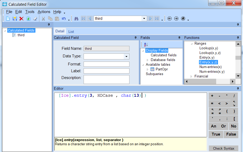

Did in another BAQ but you get the idea.
It looks close but when I hit Check syntax, it gives me the error “Invalid column name ‘HDCase’.”.
Any ideas?
Yes, I did this a BAQ for Operations. Erase HDCase and insert the field from the list in Available Tables.
Hold on, I figured it out. Where you put HDCase, I needed HDCase.Description.
I tested and it worked!!!

I was playing with it and I noticed something that threw me off. The line I wanted is the 3rd line, but to get it I had to point to the 2nd line. [Ice].entry(2,HDCase.Description , char(13))
Does that make sense?
I thought maybe it was based off of starting at 0, but there was nothing showing at 0. The 2nd line shows when I do:
[Ice].entry(1,HDCase.Description , char(13))
If in the future, I wanted the 1st line only, how would I pull that?

We might want to open a case with Epicor on this one. Entry is a 1-based array and you should be able to access any element as needed.
One thing you could try is to replace the Char(13) with a visible character (^ or |) and then do the entry using the new character as the separator. (Use the Replace function … Replace(HDCase.Description, char(13), ‘|’) for example and then pass that to Entry using the ‘|’ as the third parameter.

For the 1st line, it worked to use the separator of: char(10).
Weirdly, the char(10) didn’t work for the 3rd line, so I used the char(13) and pointed to line 2.
Kinda weird but it works, so I am going with it.
I just want to thank both of you for your help. It is nice to get an issue resolved quickly.
So, you can use the REPLACE function to remove the Char(10), newline, and then maybe the Entry will work as originally coded.
