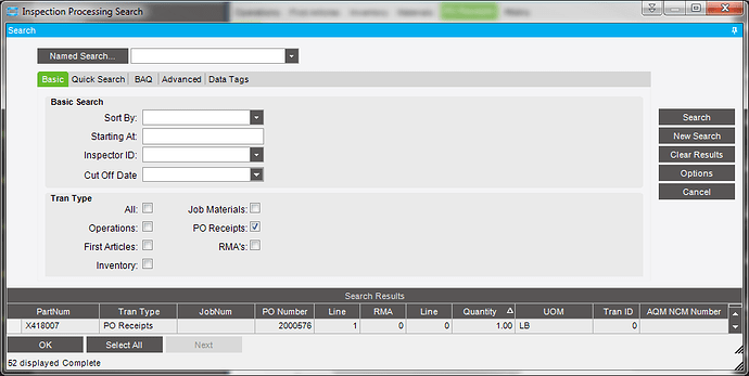

In Inspection Processing Entry, where is the Tran Type stored in database?
Hello,
Trying to create a BAQ That can filter by TranType (PO Receipts) that returns parts that are in Bin IMQA.
For the life of me, I can’t find where the tran type is stored to filter by.
You can see the column in the Inspection Processing Entry search.
Anybody have any ideas?

Hi Shawn, Trantype is only stored in the PartTran table. You can look for transactions that ends in INS. For Receipts you can check PUR-INS for raw material. and I believe there is another one called SUB-INS.
