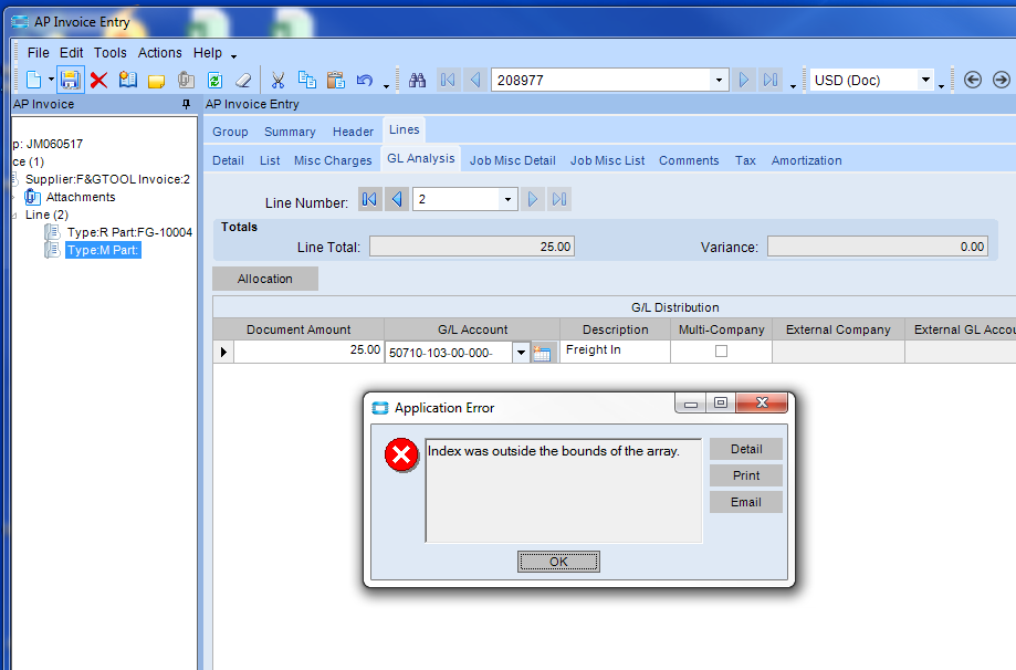

In the AP Invoice Entry Gettting GL Account to throw an Error of "Index was outside the bounds of array"
This was after our upgrade again. It doesn’t stop it from posting or saving just throw the error a bunch of times.
Check any customizations and personalizations. There may be fields with new GUIDs. You can purge personalization for a user and if that works, then do it for the rest of the users of this command. System Management | Upgrade/Mass Regeneration | Customization Maintenance
Mark W.
We deleted all our personalizations during the upgrade not to run into problems.

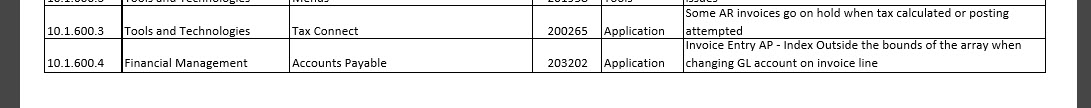

Was just reading the release notes for 600.4
Upgraded to 600.4 last night issue was resolved.
