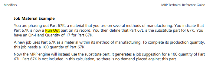

Do you know how run out w/ alternate parts set up works in conjunction with MRP? We use it but don’t fully understand what MRP is doing when creating unfirm Job suggestions with the run out parts as a material. Some Jobs have the part that is being run out, others have the alternate part. I am assuming it is first come, first serve based on available inventory at the time the unfirm suggestion is created?
The last time I checked, I don’t think MRP looks at the Run Out flag at all. If there’s demand for the part, MRP will suggest supply if required. I think the idea is for the Run Out to reduce demand slowly until supply is gone, but it’s a manual process for the move to the new part. Others may know better.
EDIT: OK, maybe I should know better. The MRP Technical Reference says:
From the 2024.2 MRP Technical Reference:
Logic/Algorithms
The Run Out functionality uses this logic to calculate its results.
  • If a co-part is a Run Out part, generate suggestions against the run out part. The substitute part is ignored.
  • If a material part is a Run Out part, then use the substitute part for the suggestions. The run out part is ignored.
