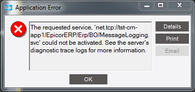

I usually Re-Install the Industry Extensions and I want to avoid doing that every upgrade. So the files are all there… Just any of the Industry Extension Entry Screens get this error:
Yet tst-cm-app1\EpicorERP\Erp\BO\MessageLogging.svc exist, untouched. Looking at its .cab file dissecting it, there is nothing it does besides extracting Client Side DLLs and Server Side DLLs.
I’ll check the Server a bit and worst case scenarion - I will do as I always have done… Reinstall the Industry Extensions from Scratch.
Not sure why I was told that I have to Reinstall IEx Extensions despite them rarely changing… It looks like all you have to do is just modify your web.config and add back the reference to the CSG Folder and it works.
add key=“AssemblyFileSystem” value=“E:\Website\EpicorERP\Server\CSG;E:\Website\EpicorERP\Server\Assemblies” />

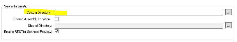

In order to avoid needing to update the web.config file, you can place this path here in the app server config.
If that Custom Directory setting is not carrying over then that’s a ticket please :slight_smile:
