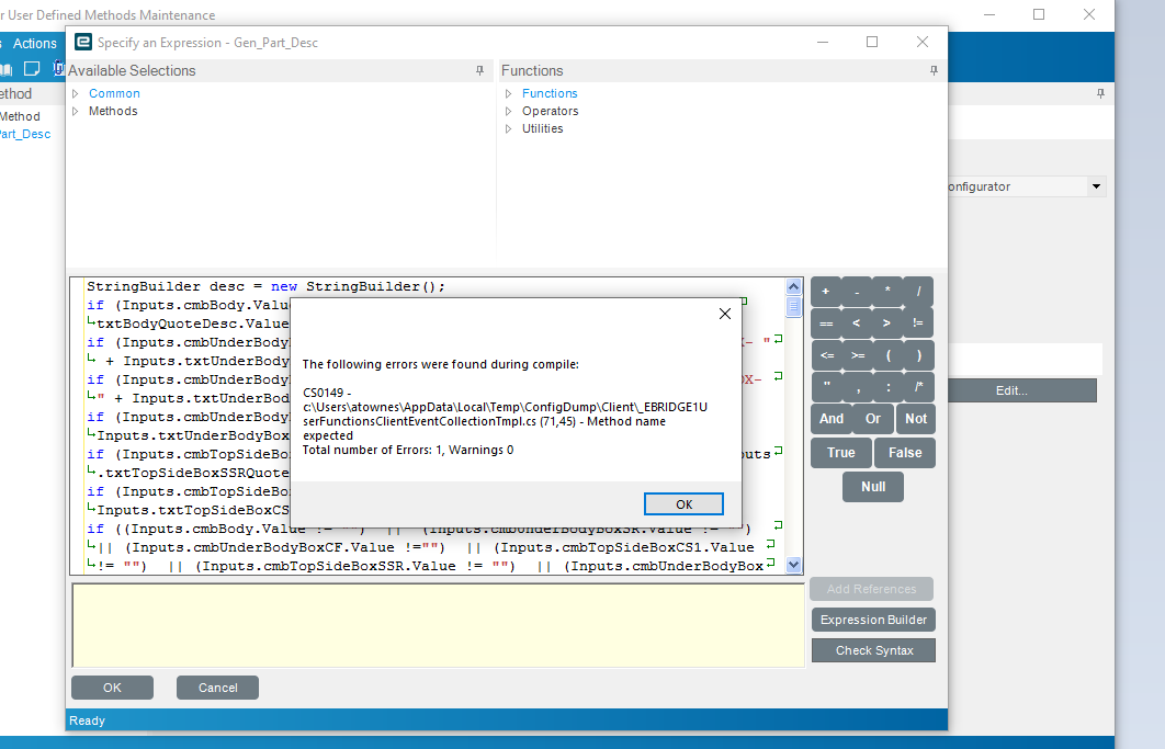

I have no idea what this error means! Can someone please point me in the correct direction?

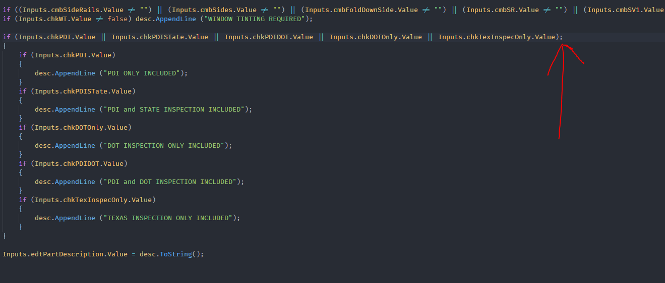

if (Inputs.chkWT.Value != false) desc.AppendLine (βWINDOW TINTING REQUIREDβ);
if (Inputs.chkPDI.Value || Inputs.chkPDISTate.Value || Inputs.chkPDIDOT.Value || Inputs.chkDOTOnly.Value || Inputs.chkTexInspecOnly.Value);
if (Inputs.chkPDI.Value)
desc.AppendLine (βPDI ONLY INCLUDEDβ);
if (Inputs.chkPDISTate.Value)
desc.AppendLine (βPDI and STATE INSPECTION INCLUDEDβ);
if (Inputs.chkDOTOnly.Value)
desc.AppendLine (βDOT INSPECTION ONLY INCLUDEDβ);
if (Inputs.chkPDIDOT.Value)
desc.AppendLine (βPDI and DOT INSPECTION INCLUDEDβ);
if (Inputs.chkTexInspecOnly.Value)
desc.AppendLine (βTEXAS INSPECTION ONLY INCLUDEDβ);
Inputs.edtPartDescription.Value = desc.ToString();

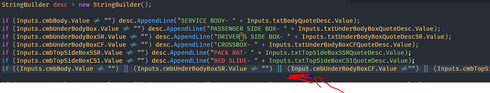

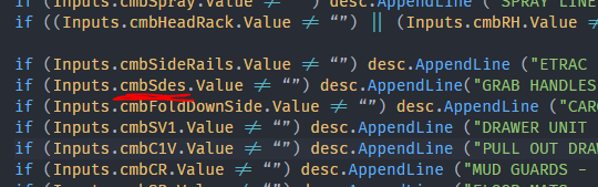

I can see now that you have multiple errors. Mostly misspellings.
At line 50 you have written βcmbSdesβ instead if βcmbSidesβ.
Give me few minutes to look through the code.
Thank you!!!

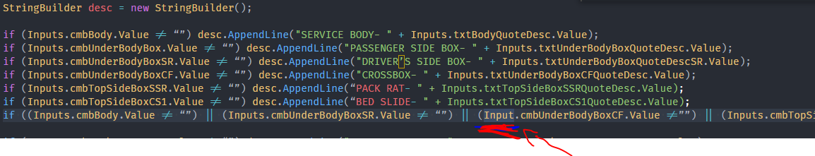

Can you try this. Some of the Double quotes used in the code were different than others, so I changed them

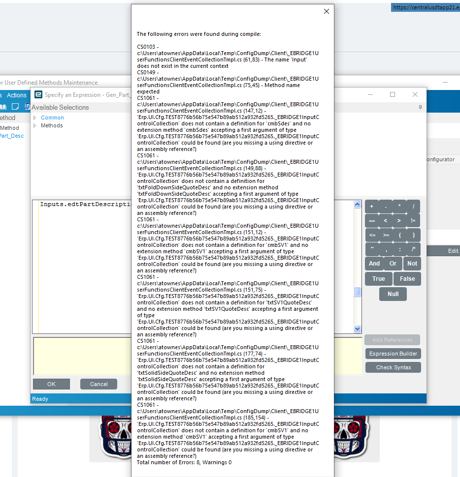

Same error againβ¦

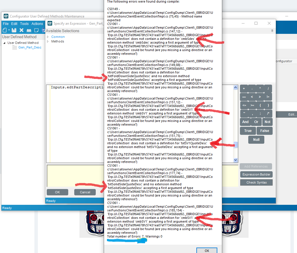

The red arrows points to the name of the input fields that are wrong. Can you validate that they are not misspelled (You can do that by clicking Ctrl + Space after the βInputs.β or by the Available selections Common-> Inputs) ?.
The text underlined with Blue shows the number of found errors.
Got it, Iβm diving in nowβ¦
Iβm not sure about this one, but I saw that there is a semicolon out of place:
Here:
Try to remove it and see if something changes.

Itβs saying that the Method name is expected, where would I put that?
The Method name is Gen_Part_Desc
_EBRIDGE1UserFunctionsClientEventCollectionTmpl.cs (20.1 KB)
EPICOR is saying that itβs in this file, but I donβt know where!

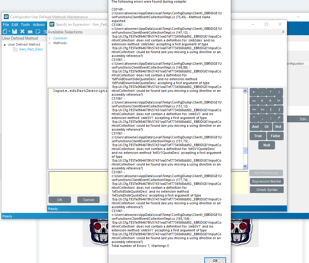

I think the problem is coming from the StringBuilder().
I replaced the String Builder with a list of strings.
List<string> desc = new List<string>();
