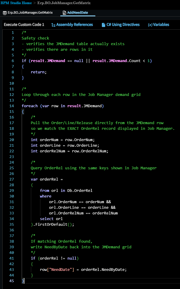

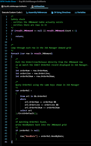

I was able to get this working.

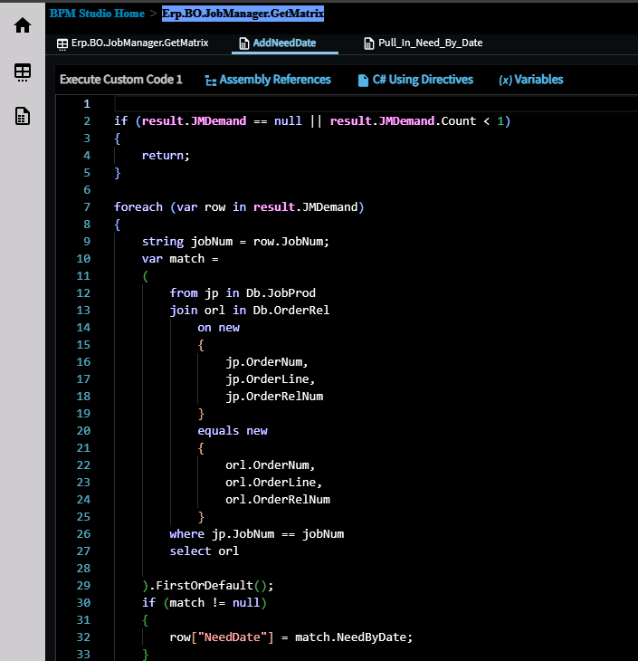

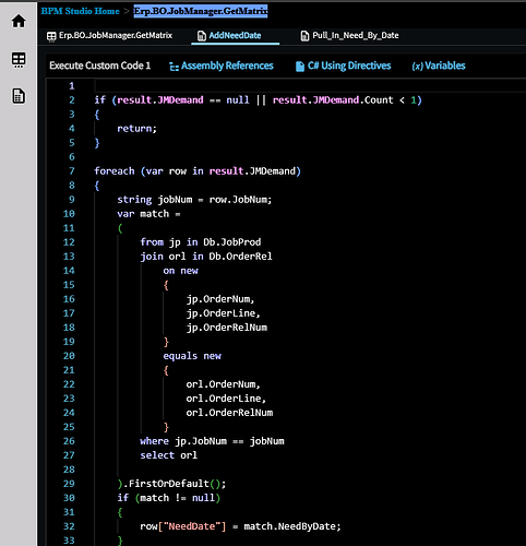

My original logic was was doing this taking the JobNum from the current JMDemand row, searching JobProd for that job, joining JobProd to OrderRel, and returning the FIRST matching OrderRel.
I think this was casuing problems since a single job can have multiple sales orders, multiple lines, and multiple releases in the JobProd table
This new solution looked at just the OrderRel since JMDemand contains OrderNum, OrderLine, and OrderRelNum.
