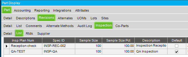

I have 2 different inspections. The first inspection is executed by warehouse receiving and identifies of the package was in good order, contained right amount of qty and shipping documents. The second inspection is an engineer that checks specific attributes of the part.
The problem I have is that after the first inspection is completed, the item is moved from INS to STK and therefore second inspection can not be executed anymore
The only way, I am able to perform the second inspection is to create a non-conformance on the item after first inspection is completed but that is not really a solution.
Are the Inspection Plans the same name/rev? What about the Specifications?
2 different Inspection Plans with different names. Also different specifications. See test example:
