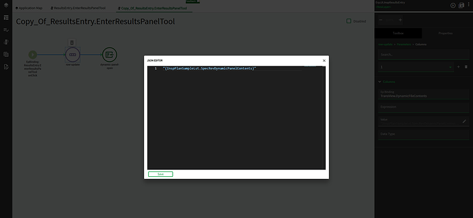

looks like a dynamic-panel-open action with basically no property values preceeded by setting TransView.DynamicFileContents to “{InspPlanSampleLst.SpecRevDynamicPanelContents}”
Which is encoded layer.json of one control per spec attribute populated from
Erp.BO.InspResultsSvc/GetInspParams

unencoded looks like this:
    "controlTypeId": "ep-row-navigator",
    "controlModel": {
      "guid": "8017d577-fa2c-4762-8fde-188c9fb18c32",
      "labelText": "Results",
      "id": "rowNavResults",
      "epBinding": "ResultsEntry"

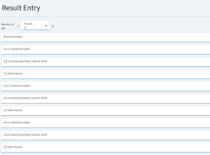

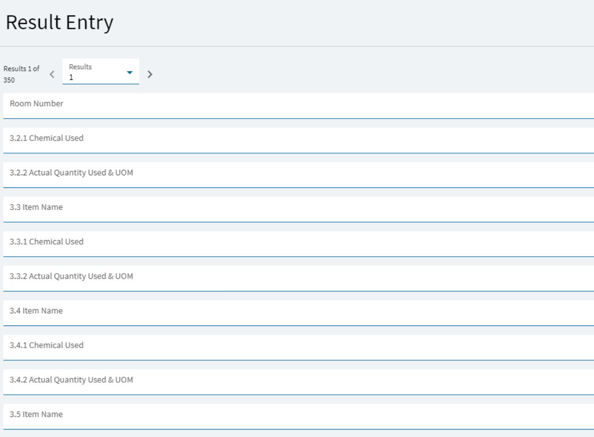

dynamic panels. who knew. pretty neat possibilities.
I haven’t tried a long one yet, but the built-in panel will probably render in a list like this example from the help file and it’ll be endlessly scrollable:
Alternatively, if you design your own panel, you can do anything like use tabs for sub-pages etc. here’s a single pager custom panel from help article:

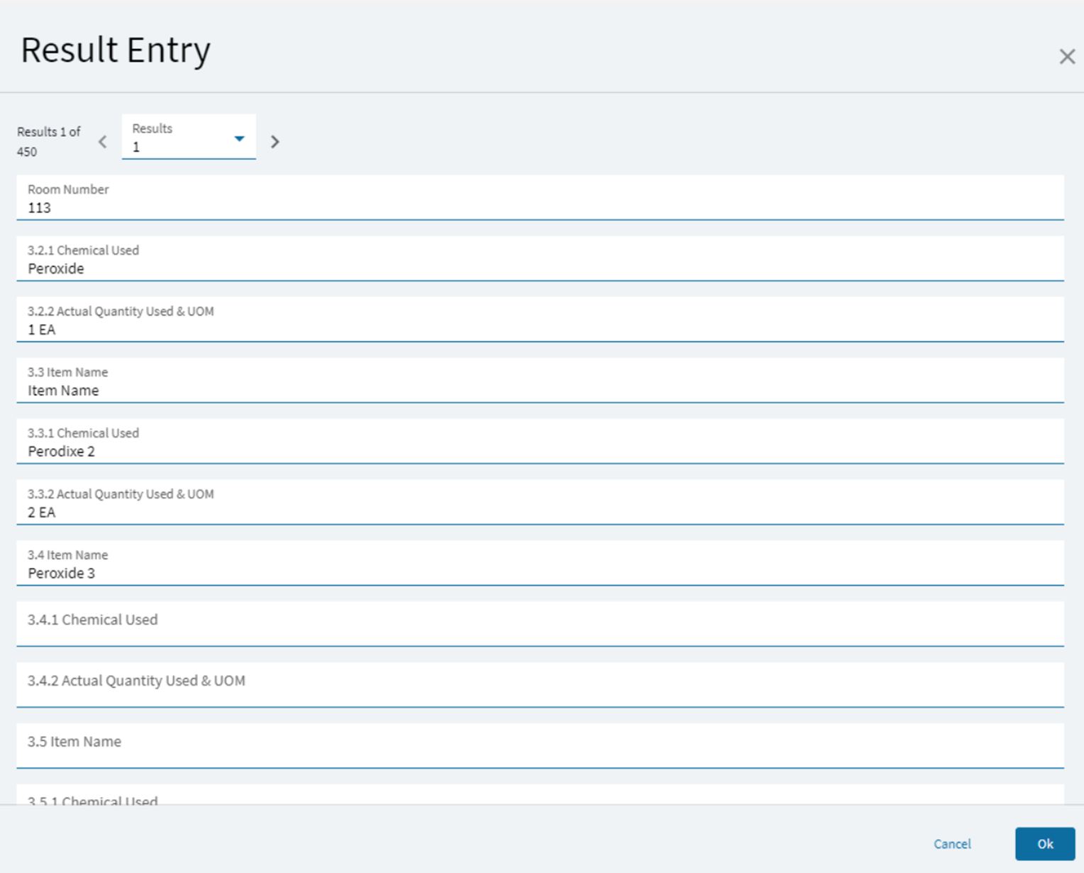

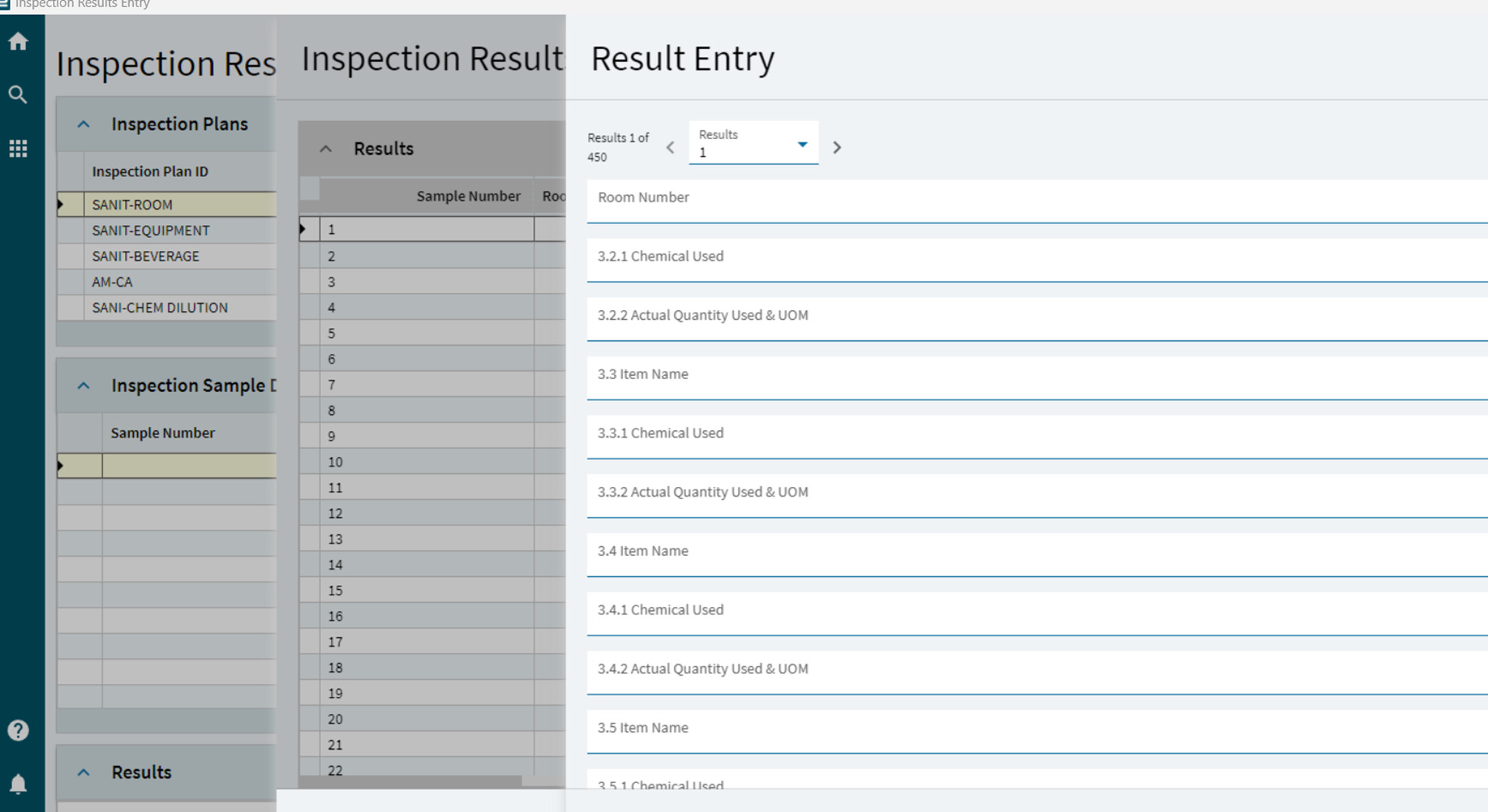

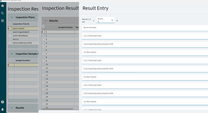

Thank you everyone for posting that Epicor can now handle the entry better!!
I didn’t go full bore but was able to use Inspection results entry to enter data in a top to bottom fashion and it is similar to the custom form. At least enough to get data entry done!
I accessed it through Inspection Results entry
  1. Generate Test Set
  2. Then Select [Enter Results]
  3. Then select [Enter Results Detail]
Pretty sure the custom code no longer works.
This should work through the MES but right now there is a bug with Linux containers and the MES so I cannot get there to try it yet.
Included the form (note I have not made an application or layer this is raw built in Epicor functionality)

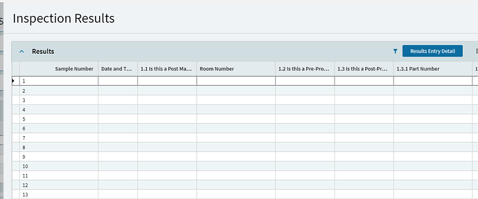

I have an old dashboard that parses the inspection tables and the results are in there!
However there is a bad side to this.
You can specify the order the items are to be in but this only goes for the horizontal entry not the vertical. That goes in the order you save the specification attributes in. Some of our plans have many dozens of items. It is not feasible to rewrite the entire plan if we have to insert an element.
Second bad item, any custom code is gone. I mean we knew that but for Epicor to not offer an easy way to fix it?
