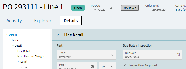

So here is what I’m seeing. On the Purchase Order entry page, we click inspection required. If we receive the PO into receipt entry it correctly checks the Inspection required checkbox on the receipt entry page and selects the receiving warehouse and bin from site configuration.

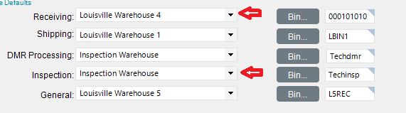

There is a default receiving warehouse/bin and a default inspection warehouse/bin.
If something is not marked for inspection, it will go to the first one. If it is, it will go to the second.

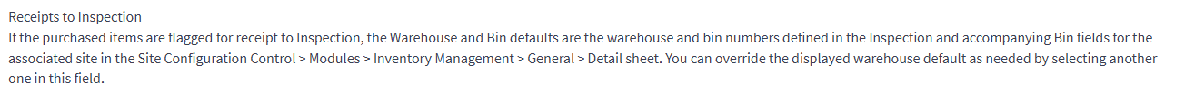

KB0070048 might be helpful

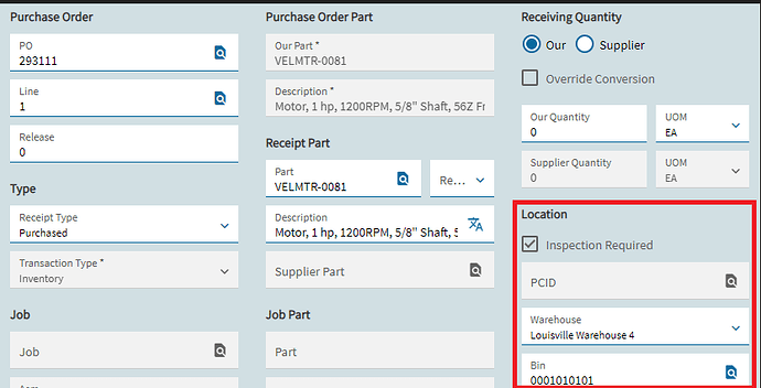

If the PO doesn’t have inspection required and I click inspection required in receipt entry it works correctly.

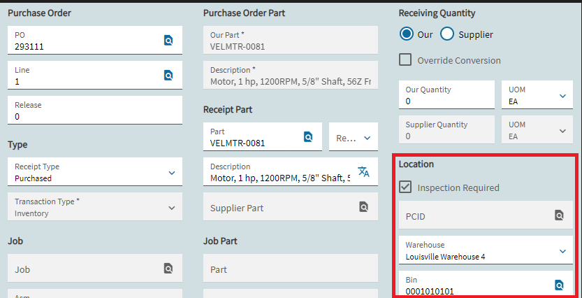

If the PO has inspection required, inspection required is automatically checked in receipt entry but the warehouse/bin is the receiving warehouse/bin not the inspection bin.
Purchase order entry
Receipt Entry
I’m wondering, is the part actually going into that WH/bin? Or is it showing that it will go to the wrong one but actually goes to Inspection?
I was thinking that the process will be to receive into that warehouse/bin and create a pending inventory Whse→Whse transfer transaction for the inventory to be moved into the inspection warehouse for inspection - since you indicated that these are not the same place (even though they might be in reality, Epicor sees it as different places).
