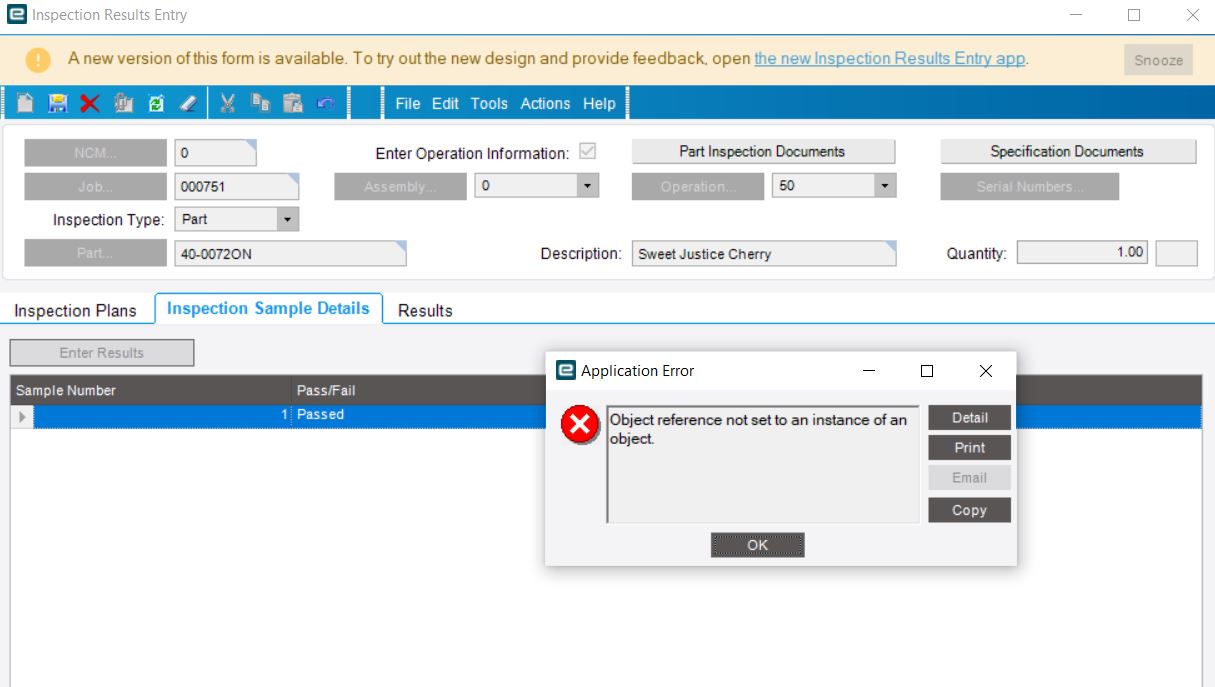

Inspection Results Entry throws Object reference not set to an instance of an object when trying to enter results
Whenever we try to enter inspection results we receive the following error
Object reference not set to an instance of an object.
Now I checked the plans, they look good. I can also test the plans through Configuration Entry.
Lastly they were working as of a few days ago. Yesterday evening Epicor updated and the next morning I’m getting flooded with error messages.
I checked Pilot and get the error there as well and those plans were also working.
Anyone run into this? Verison 2023.2.9
