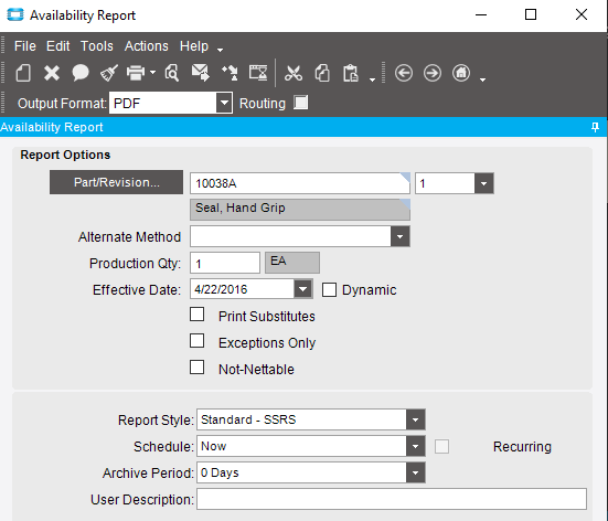

Are you trying to recreate the Availability report?
Sort of, looks like this report checks onhand and shows
how much will be the shortage. I am trying to build BAQ which would provide total sheet metal demand for given list of BOMS. Seem I made it work bay adding in to CTE cast ( PartMtl.QtyPer as nvarchar(25)) and to Union ALL cast ( SubQuery1.Calculated_QtyMultiply * PartMtl1.QtyPer as nvarchar(25)) but why it does not accept direct field value without adding CAST?
By the way Availability report is quite good, did’nt knew about this.
