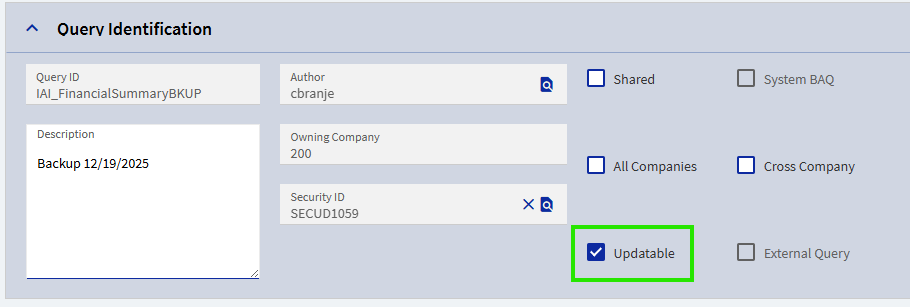

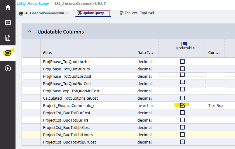

Right, do the dashboard instead. Updatable BAQ. Then you have your grid like Excel again. It’s a great way to make everyone happy and force good data.

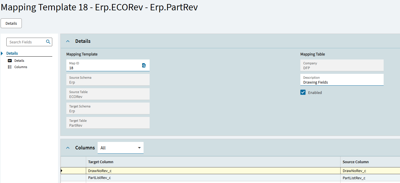

Could these same fields be added to engineering work bench and quote engineering? We pull details from these 3 different places so it would be nice for them to share the UD fields.
When you say we can have a grid like excel again do you mean they can enter and delete data right in the dashboard itself?
I don’t think I’ve ever added fields to the Revision tables but I don’t see why you couldn’t, you would face the same limitation AFAIK though, you would need to add the functionality to copy those UD field values into the appropriate UD fields in the Job/Quote.
And yes, if you setup the UBAQ properly it can add, delete, modify data in Epicor like you would in excel.

Yes, but make sure that you update the UD Column Map for all of those tables (in both directions, i.e. Source: PartRev to Target: ECORev, and Source: ECORev to Target PartRev). That will handle, for example, writing from Engineering WB to the Method when you check the Rev in and writing properly to the Job from the Method when MRP/Quick Job Entry/Get Details from Method/Job creates the job, etc.
Oh you’re kidding, THAT’s what that is for? I wish I had known this.
Can I get a time machine? I need to explain this to myself in 2021.

Is the “Updatable BAQ’s” a separate module for kinetic?
Nope. Just mark your BAQ as updatable and then set things up in Update Settings.
