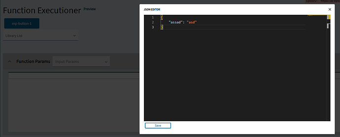

Ok, I’ve updated the OP with a new copy of the cab that now supports DataSet Input types
There is a bit of a quirk because of the way that the JSON Editor works, when you focus on the JSON Editor it hides the execution panel, but simply click execute function again and it will keep all your changes. (See below)
ExecWithDS
Here’s a sample “DataSet” to use with the SayHelloWithDS Demo (its a mirror function it just gives you back what you give it plus a little meta data
