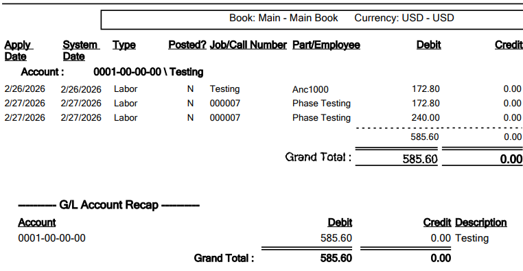

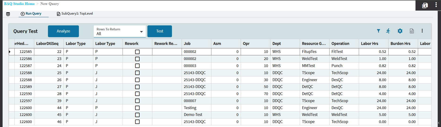

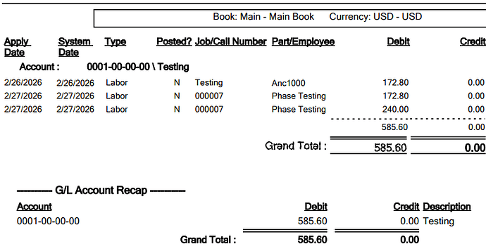

Hi, I have been working in Inventory and attempting to generate the Inventory COS/WIP report using labor entered via Time Entry for jobs configured as Project type. Below is the current information shown in LaborDtl:

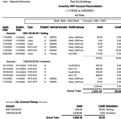

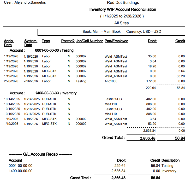

But in the COS/WIP report the following, I only get the Jobs of type P and not J:
Am I missing something? Thanks in advanced

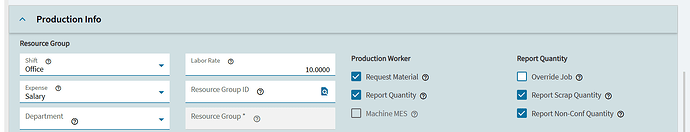

Do you have Rates on the Employee

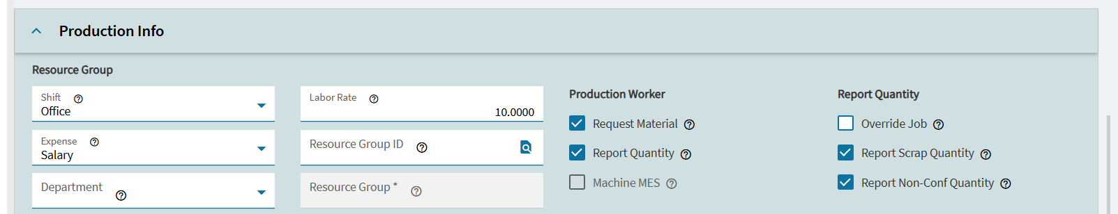

This is what you are referring to right?
Seems that was what I was missing!
yes.. if employee has no rate it wont be printed on Inventory WIP as there is no cost.
