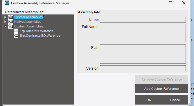

Here are the custom assemblies.
Something may have changed as this type is not being found using the assemblies/references already present.
is using Erp.Adapters; present in the usings?
Nope, WarehseAdapter is still correct.
Yes, this was present in the usings. I was able to rectify this by creating a NEW base and instead of manually adding the assemblies I went here:
Tools > Wizards > Customization Wizards > Reference Adapter/BL Assemblies > Get Adapters > WarehseAdapter
THis got rid of the error. Code compiles file now, no errors…
