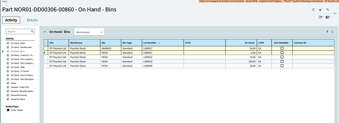

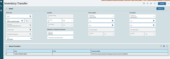

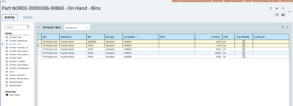

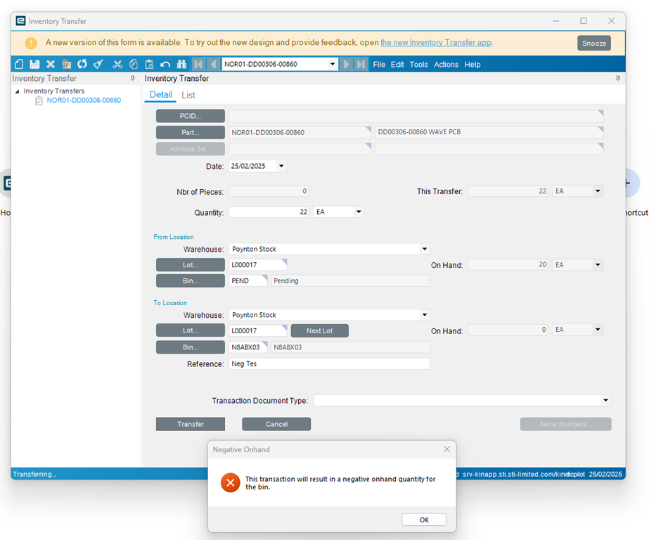

Not sure if anyone has noticed previously, in Inventory Transfer if i perform a transfer in the Kinetic UI it ignores the rules regarding Negative on Hand Action and allows the transfer to happen. If i perform the same transaction with the same details in the classic screen it gives the error as expected.

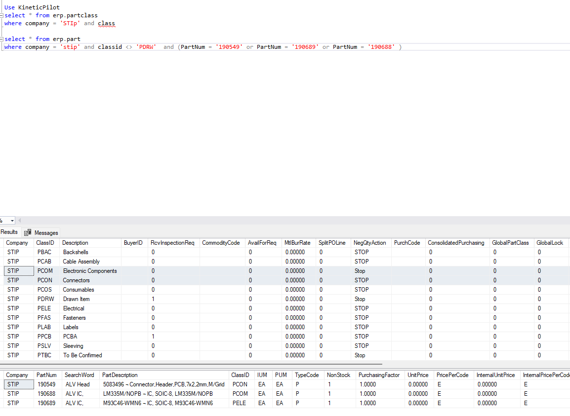

I have been doing some additional testing and notice that in the DB some class ids were STOP and some were stop. PDRW was originally STOP as loaded by DMT and did not follow the Negative Quantity Action rules. When i changed to Warn and the back to Stop it did follow the rules. I did further testing on three other parts, two was STOP that allowed the transaction to work and the third was Stop which showed the error.

I would have thought that if STOP is wrong it would have been rejected by the DMT, however as it wasnt and loaded AND worked through the Classic UI i would have though that the Kinetic UI would accept both STOP and Stop as what enables the Negative Quantity Action Rule.
