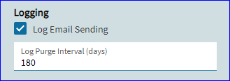

Email log blank. I am going to assume I have to pay for that and then set it up. Since the MailLog table was mentioned, pulling from the API looks like there is nothing. That’s not good.
You just have to enable it. You have to set how many days the email history should be archived before it will show anything.
As @aosemwengie1 noted… need to turn on logging of emails via Email Setting Maintenance.
