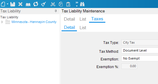

Any reason we are not using the built-in tax capability of Kinetic?
You get the reporting afterwards for free.
Where is this one to be found, and how is it to be filled in?
I searched for “Tax” in the menu system. The best way to learn it is to use your Pilot and trace transactions. There will be some basic information in the User Guide and online help.
