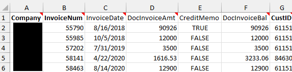

Here’s a snip of my Open Load template when we went Live:
Our last open invoice number was 60775. So our starting Invoice number in Epicor was set to 70000.
Note one of your errors was that your invoice balance could not be less than zero. See the first entry in my DMT template. In AR Invoices, you can set Credit Memo to “TRUE”… then pass a positive number.
But… the point of AR Open Load is that you’re loading already open, existing, invoices into Epicor. So the invoice numbers will already exist (generated from your old system), and once you DO go Live and Epicor generates its first invoice, it will start at 10000 or whatever you set that value to in Company Config.
