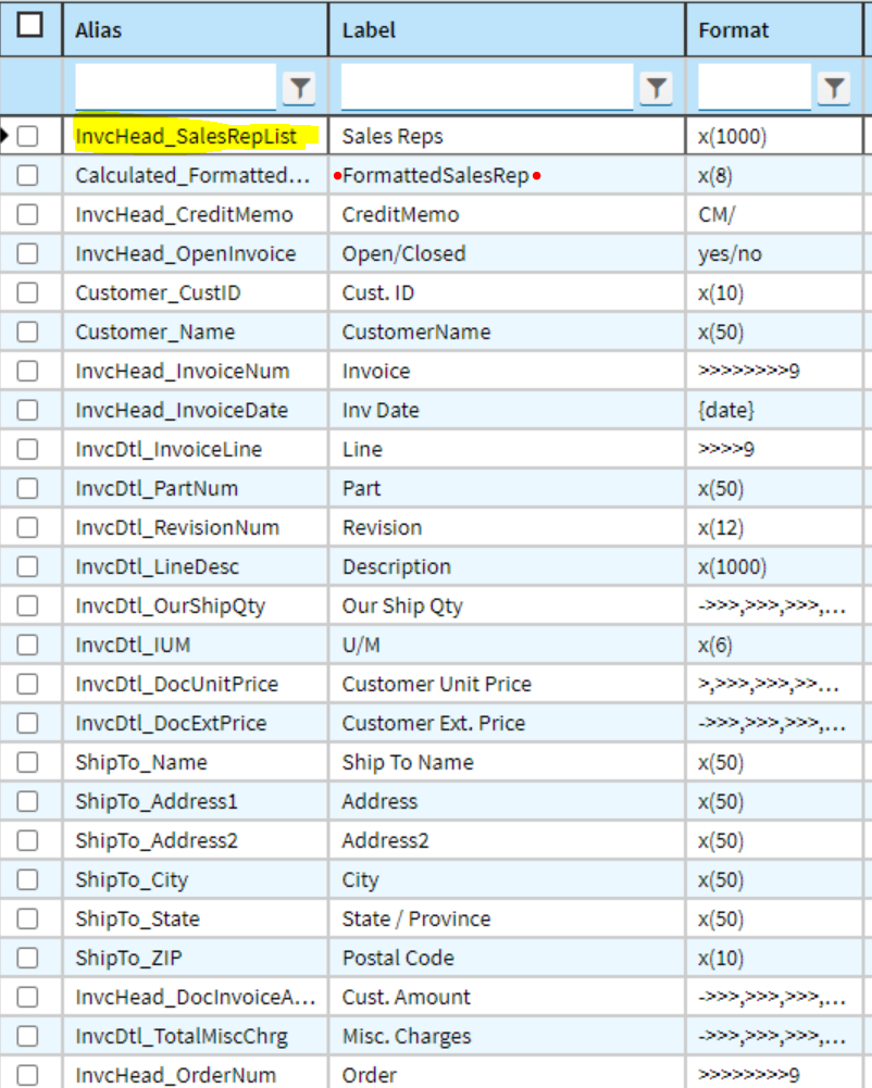

The SalesRep field has initials in it and they want to see the full name.
I tried the InvcHead table.
Field is called SalesRepList
I then created a calculated field
Field is called FormattedSalesRep
case statement says
when [Customer].[SalesRepCode] = ‘JD’ then ‘Jane Doe’
when I run the BAQ, JD might = Default instead of Jane Doe.
I don’t know why but I feel like I’m using the wrong table / field?

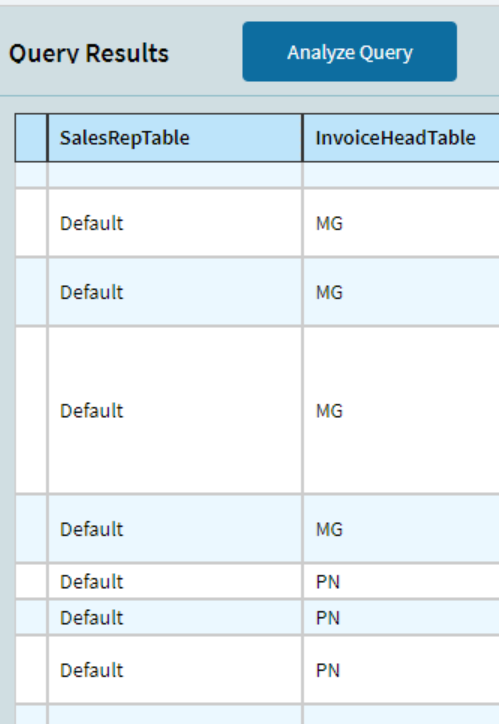

I have tried the SalesRep table.
The sales rep in the SalesRepTable appears to be DIFFERENT from the sales rep in the InvoiceHeadTable.

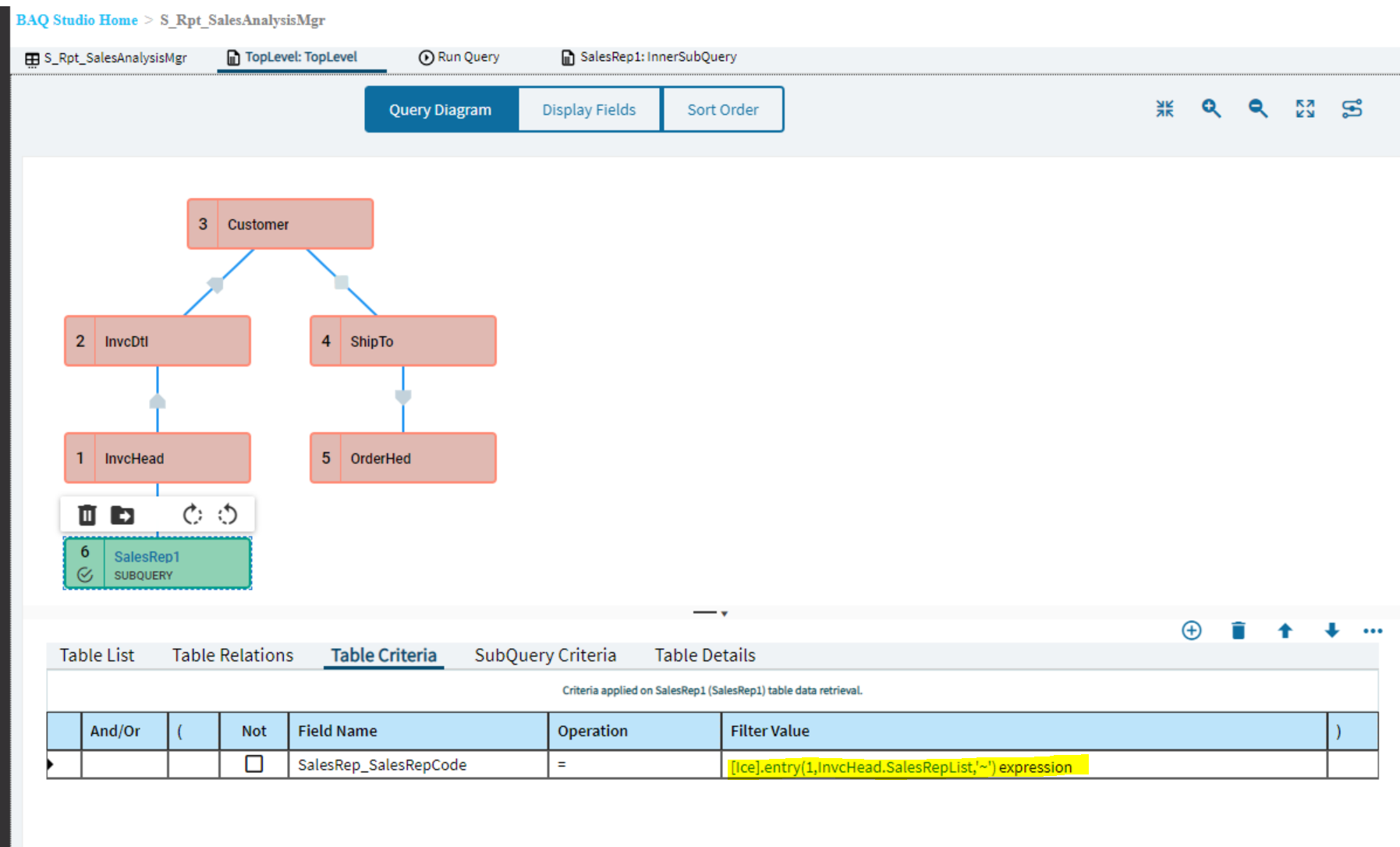

This video solved my issue!
I needed to pull the sales rep list from the invoichead table
then create a subquery to bring in the salesrep table, the sales rep code
tie the subquery to the invoichead table
connected the two on Company alone
then added a table criteria to the subquery to bring in the name of the sales rep.
I had to use the function called ‘ranges’
