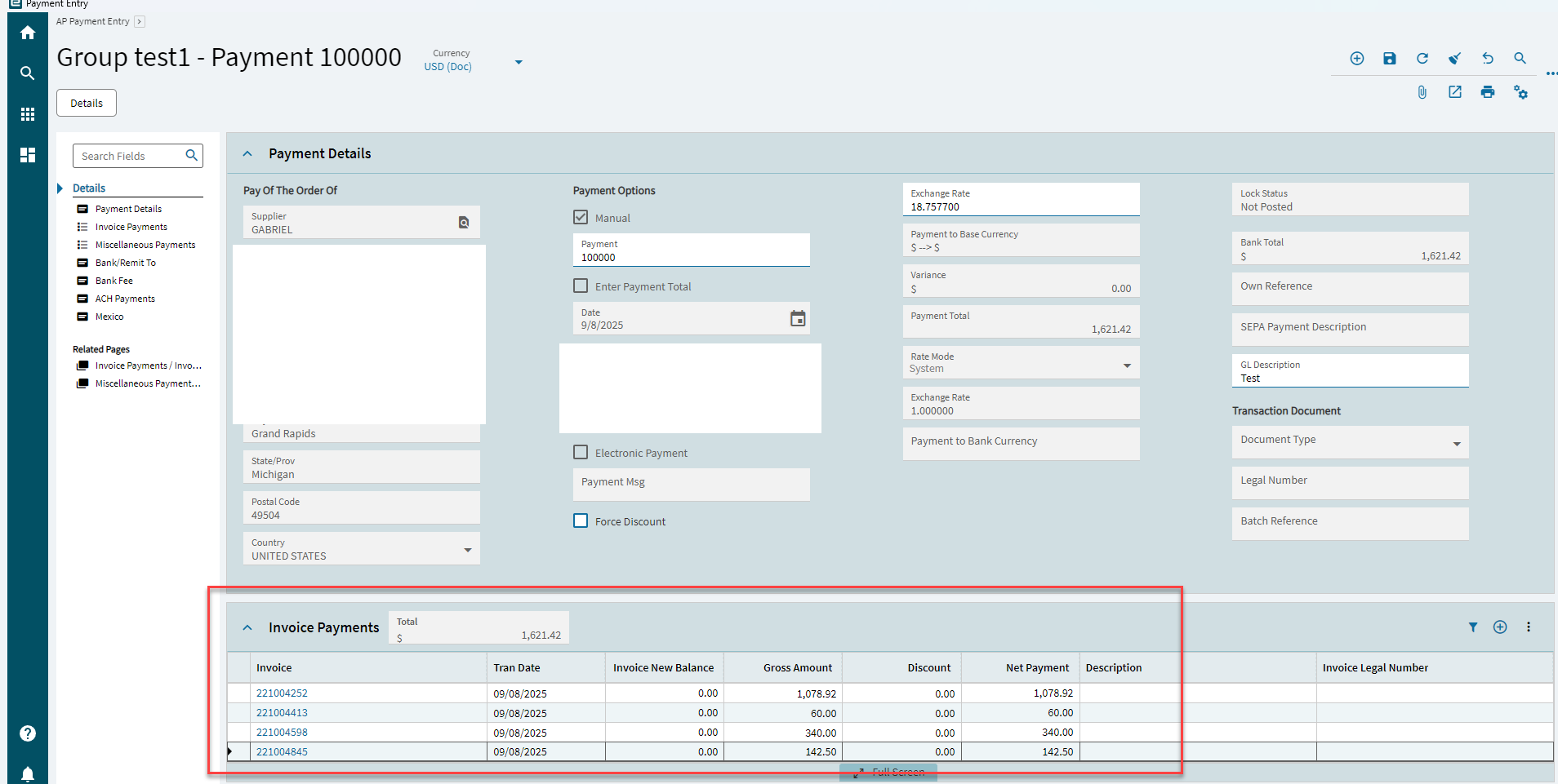

Hi Scott, are you talking about to add in an easier way invoices in the following section?

Hi Raul
Yes, she is looking for an easier way to add invoices. She has not made the jump to Kinetic UX yet. Is it easier in Kinetic?

Try this
Create Group
Set bank account, select payment method (Wire)
Click Actions >> Select invoices
Click on filters tab / Payment method
Select All
Click on Supplier Tab
Select your supplier
Set your dates if needed
Click OK
Pick your invoices
Should do the payment selected for the group
Test first
The other thing to check is what the payment method is on the supplier

I went through your steps in TEST, and it does work as you say.
From my screenshot of what she was doing, she was on another tab.
When she can make time for me I will see exactly what she is doing. I think she was selecting New Invoice Payment. This forces her to individually select invoices.
