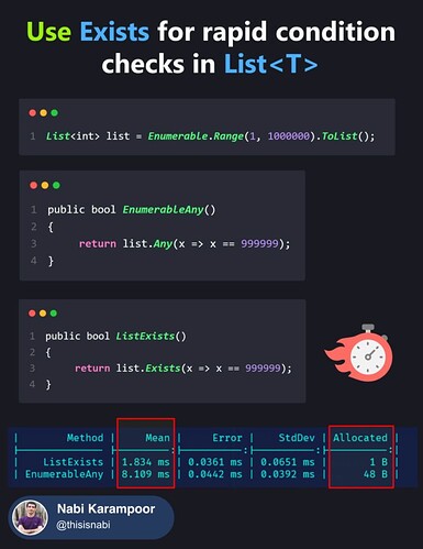

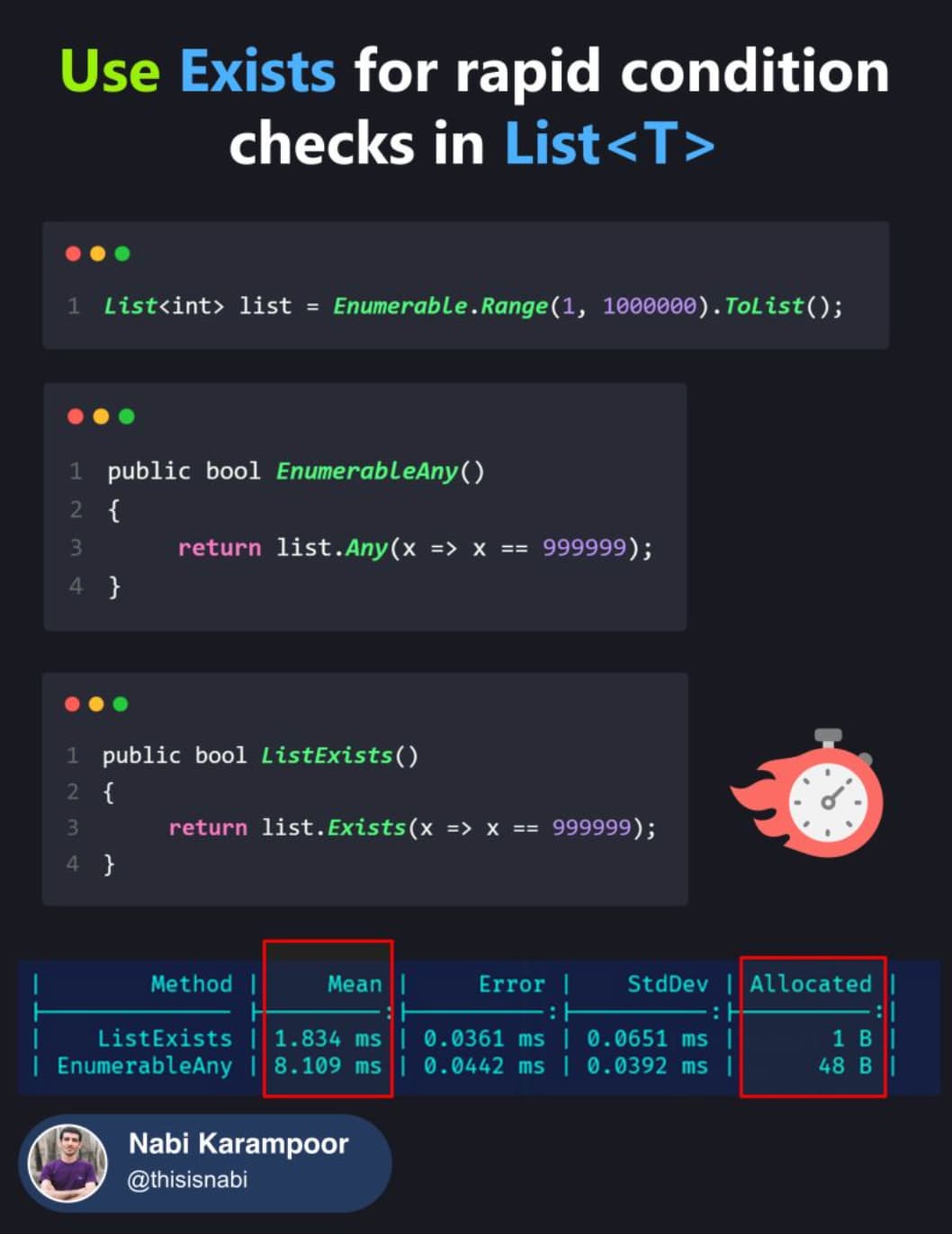

Is .Any of this true for Kinetic?
From: Sign Up | LinkedIn
Or am I missing something?
I wonder behind the curtain what the difference is. Wowza. Never heard of Exists before
Looks like Linq to SQL doesn’t have EXISTS
It is also worth noting that instead of doing an Exists query in SQL ErpContext is doing the much more complex query below… (for .Any())

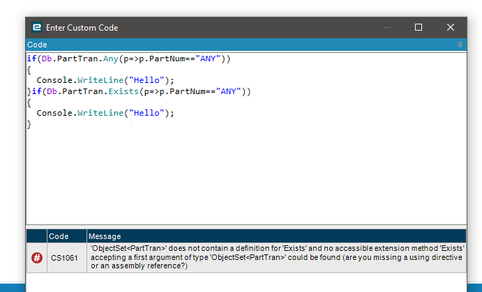

Hi Jose,
The “Exists” belongs to type List, so you have to convert your ienum using ToList() first.
Regards,
Sure but to List() removes it from SQL brings the entire table into memory and then does an exists ( believe… checking now)
Correct. There is more allocations there so … I’m waiting for someone to benchmark it :slight_smile: :popcorn:
Yeah as I suspected that’s way worse it does a full table select into memory
