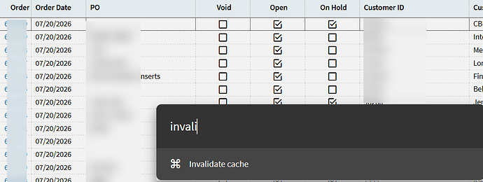

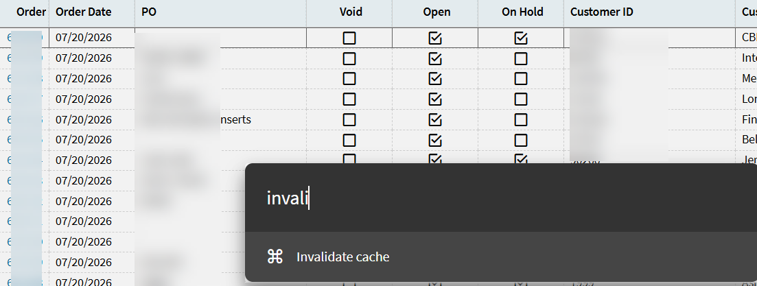

Ctrl-K then type invalid then select “invalidate cache”
