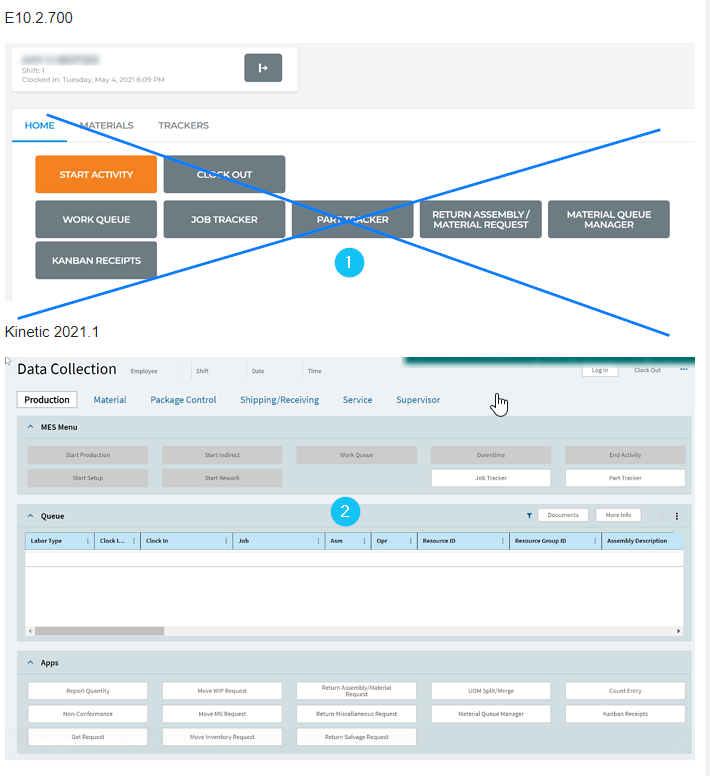

Bruce - Change your URL to /home/#/?mode=MES
@Edge - is the “new” style MES going away or will there be two Kinetic screens available?
E10.2.700
Kinetic 2021.1
That’s too bad about the (1) version of MES - it was really a clean view of MES and I had a lot of positive feedback from customers.

From this post, I just realized I was am testing the old Kinetic MES and not the new one even though we are testing Kinetic 2021.1

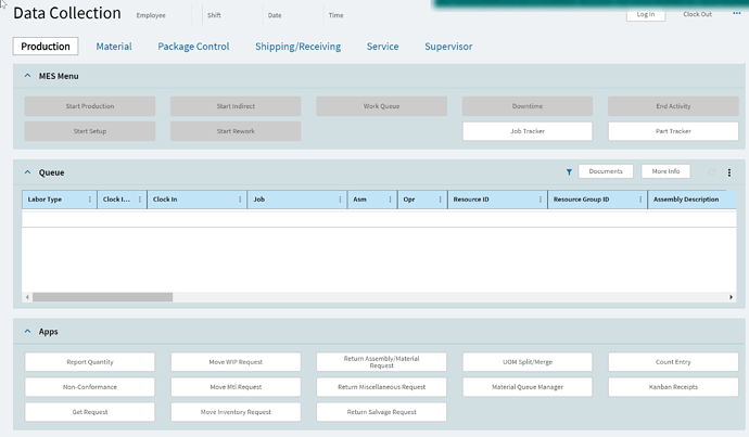

Before I explain how to modify the relevant screens to utilise new customisations, we need to understand what actually happens when you launch your Kinetic client with commandline parameter /mode=MES, add /#/?mode=MES to home page address (or use /mode=DC and /#/?mode=DC in patch release .5 and later that is currently being worked on)

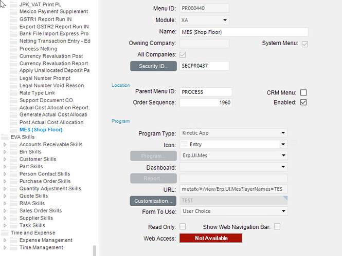

With Kinetic 2021.1 we deploy a new menu with menu ID PR000440. It is available as one of the last items among Processes in the menu maintenance (all items under processes are not directly seen in the menu tree and invoked indirectly, so you do not see this menu in your regular menu tree):
Once you apply your Application Studio customisation to this menu and relaunch Data Collection via commandline parameter or browser URL query, changes in your customisation will be applied to default Data Collection screen. This change will be applied to both browser and smart client sessions.
In Data Collection mode, unless you are a security manager, you will not get access to most of the menu in the sidebar of the shell.

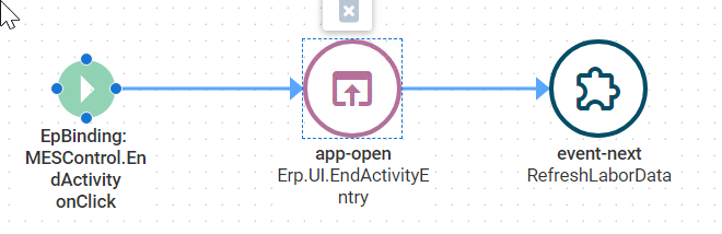

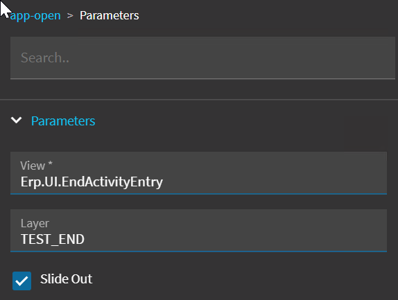

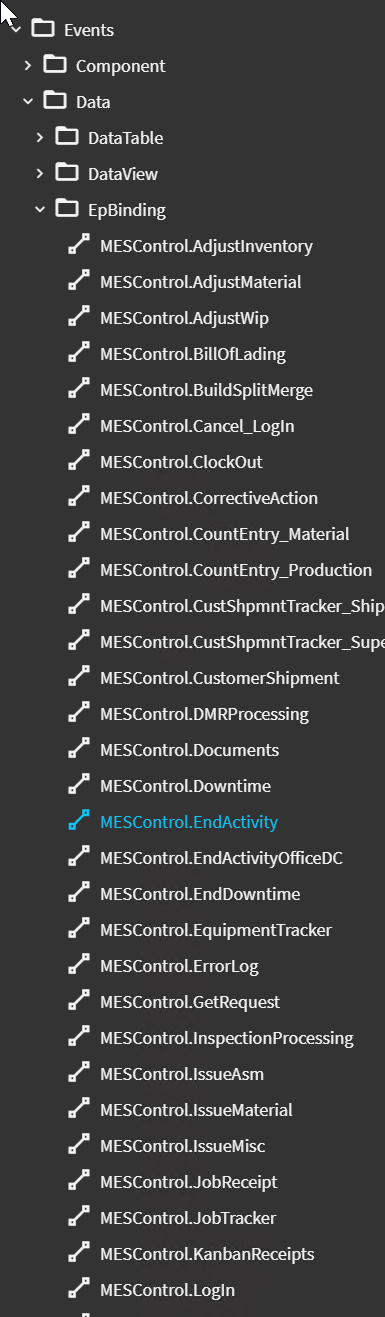

In order to customise the screens invoked from the main Data Collection screen, you will need to modify events that are invoking them as part of your main Data Collection customisation:
Each of the relevant events will have app-open event action defined:
Under properties of this action you can define the layer to use:
You can also tweak if the screen shows as slideout and a number of other options here.
Hope this information helps you get started in tweaking you Data Collection screen to be as simple or as complex as you want it to be. Please remember that you can always add new actions, calls and functionality to your Data Collection via Application Studio and that with Epicor Functions you have access to dynamic APIs that allow you to implement new serverside business logic.

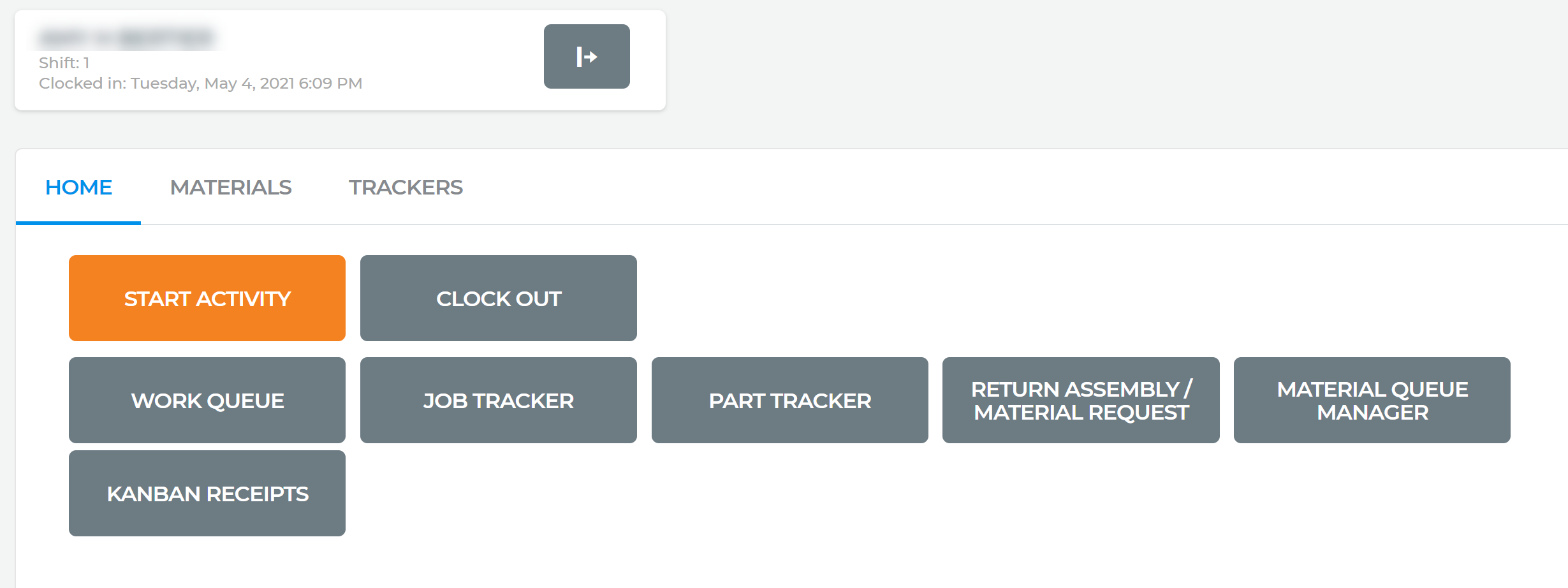

What I don’t understand is how I can have different customizations for MES going at the same time.
Unless it is the user is setup to launch a process?

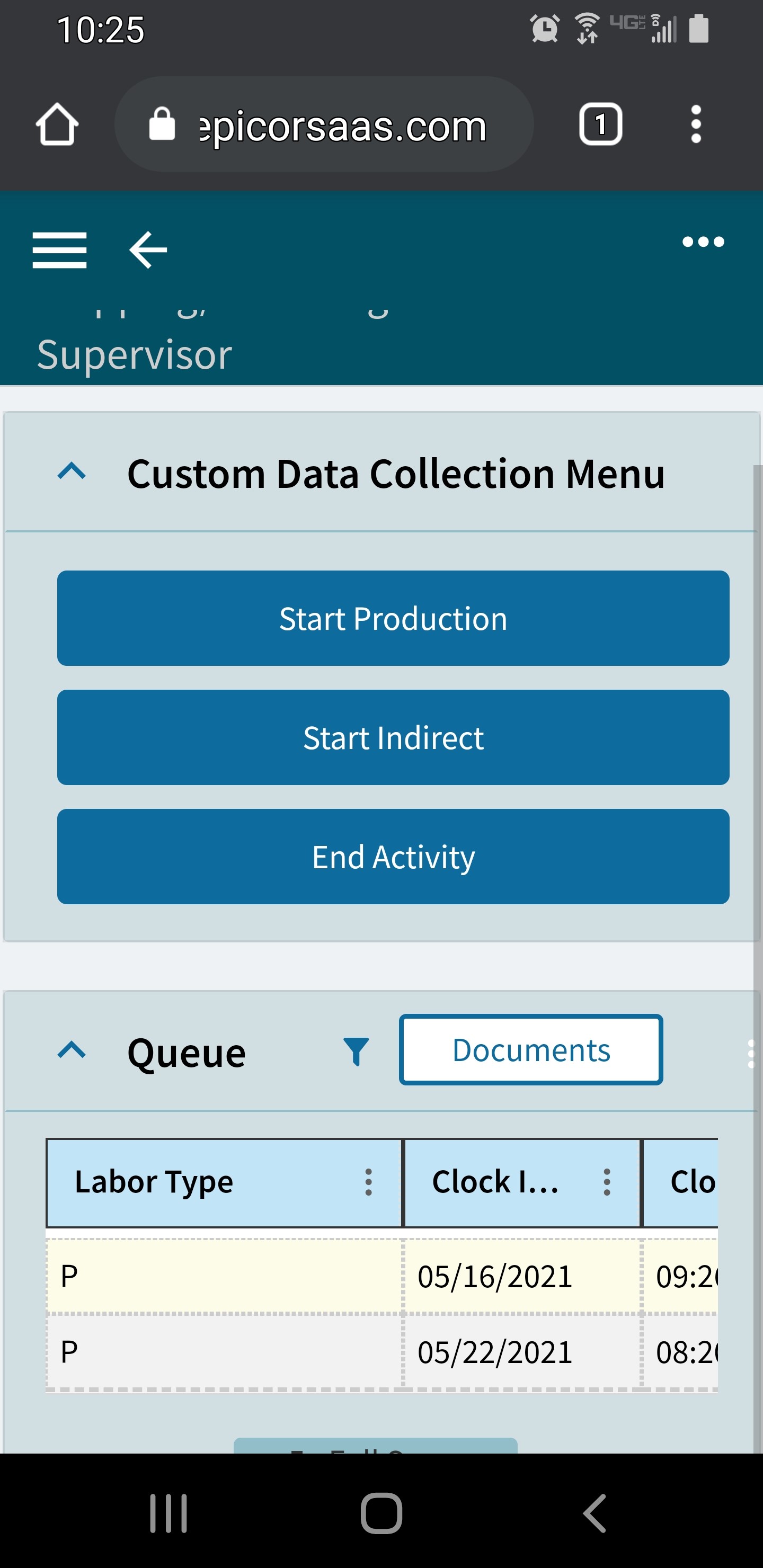

I was successful getting a simple MES menu started and also launched it on my phone.
