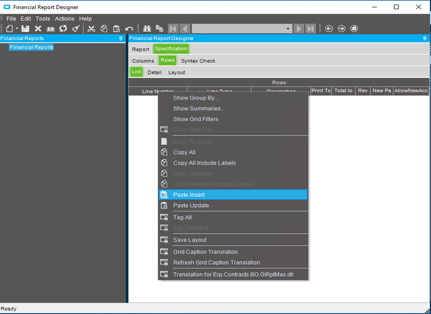

We had a user accidentally delete a column set of the Balance Sheet report in Financial Report Designer and I cannot figure out how to get it back without restoring the database over LIVE which is something I do NOT want to do. I have a copy of the Balance Sheet report that is good in my Test Database but I cannot figure out how to export it out and re-import it back into LIVE. Is this possible? How can I get my Balance Sheet report back to the way it was without having to restore the DB? Thanks in advance!!
Just use the paste insert functionality in the Row List sheet datagrid
Copy rows from test and paste insert on production report designer
OK, I’m gonna give that a try. Thanks so much!
You will have to create a column set first before you can paste/insert the rows as the rows need to belong to a column set

Mike if it is just a row you need to add back, in the financial report designer click on New Row. Make sure the row line number is changed to fit between any existing rows and you can reinsert that row back into your report without starting from scratch
No, it was a column set that got deleted. I was able to copy/paste from my TEST database and that fixed it right up. Thanks to all for the help!!

Hi Mike,
We lost a column set that was accidentally deleted as well, I have tried to copy the column set from backup database and then paste but that results in nothing being pasted.
I am doing this in financial report designer. What did you use to copy and paste?

Make sure the rows line up exactly the same in your Test AD and the one you’re pasting into.
