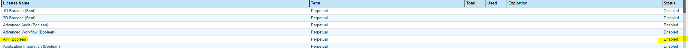

We’re installed on premise, not cloud. Not sure if that matters. And in our licenses, I see that ā€˜API’ is ā€˜Enabled’
