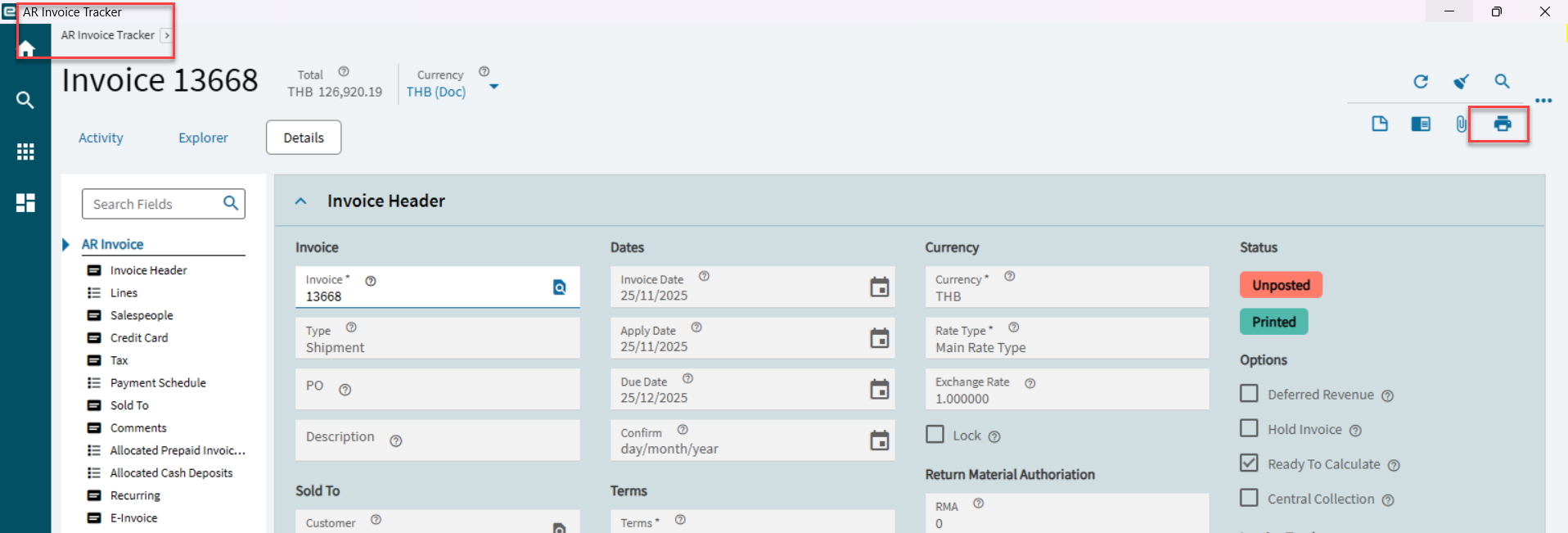

Is there a way to set permissions for some users to not print on the Ar Invoice Tracker page?
Is there a way to set permissions for some users to not print on the AR Invoice Tracker page?

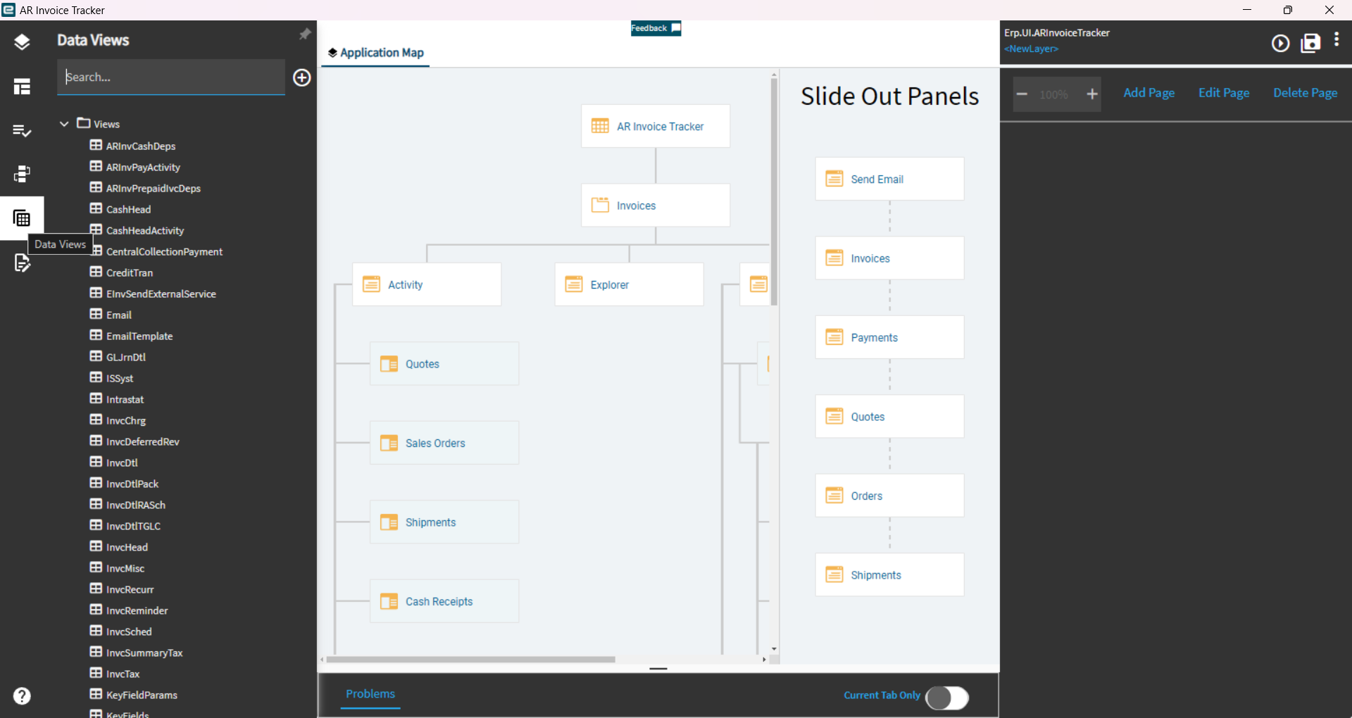

You can disable the tool based on user security by adding the UserFile dataview and then adding a data rule.
Below is an example:

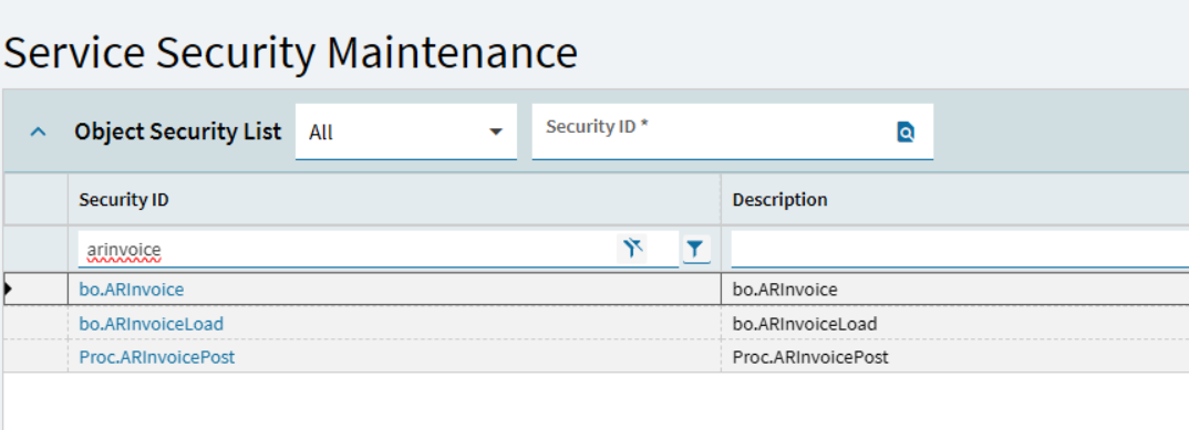

Where do I enter?
Service Security page
