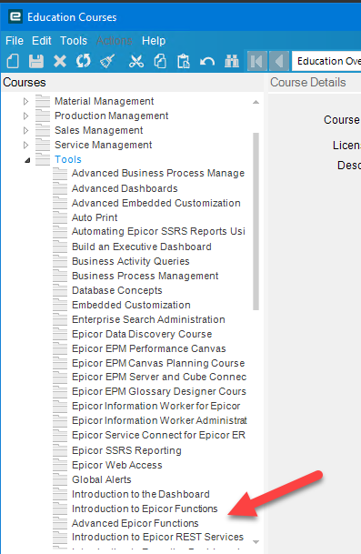

You can do this with Epicor Functions check out the Advanced Functions course where they integrate with the ZipCodeAPI as an example.

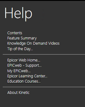

It it in the embedded education. If you are licenced then you should see it the help menu (Modern Shell)
Education Courses right? Sorry but I cannot find Advanced Functions course in this one.
Correct
I cannot find that, could you please provide specific path. Thank you

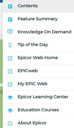

It appears they introduced those courses in 10.2.600. Looking at your screen shot you either have 10.2.400 or 10.2.500. If I’m wrong and you do have a version greater than 10.2.500 then using the Metro/Non Active homepage UI you should be able to get access the Education courses from the Help menus.
Thx u, found it
Any idea how to get to this ‘Advanced Epicor Functions’ course in kinetic cloud?
