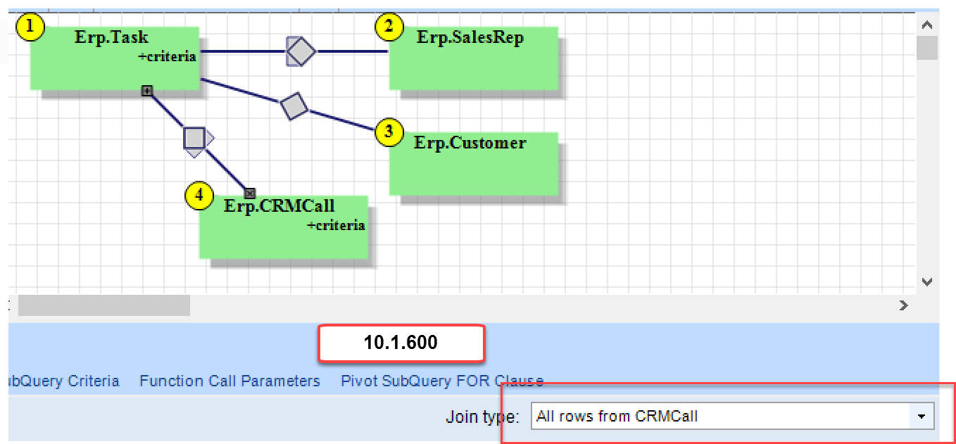

Issue found with BAQs in E10 Cloud upgrade to 10.1.600

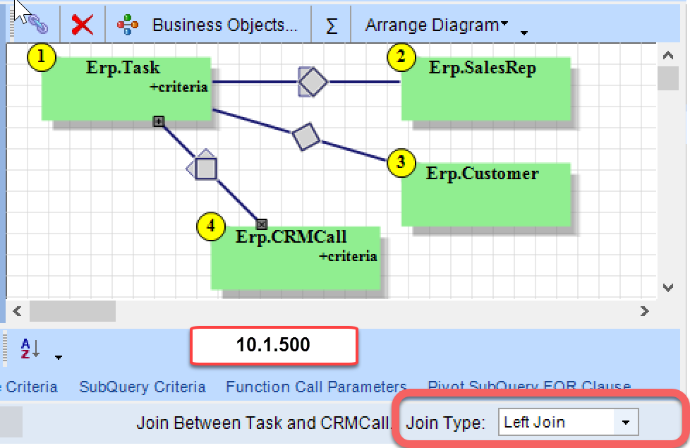

The BAQ designer has a new way of setting Left and Right joins
In the upgrade to 10.1.600 the open join was turned around.
New terminology instead of left and right it actually states the table that you want all records returned.
