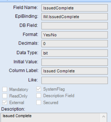

trying to build a BAQ to show me all the materials where the Issued Complete checkbox is not selected but the technical details are not showing and DB field and I’m lost on how to accomplish this, any guidance will be appreciated.

When you don’t see a DB Field, it usually means that it is calculated from the Business Object.
I believe what you are looking for is JobMtl.IssuedComplete
