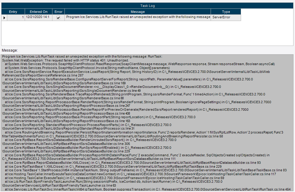

I would be running reports no problem and the all of a sudden I get this error and then I can’t run reports any more. Does anyone have any idea why?
some times if I wait a while, then I can run reports again. This can become quite annoying.
