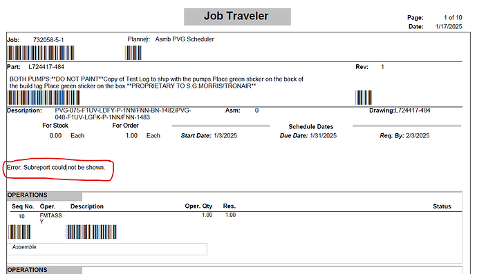

Over the last few weeks, despite not making any changes to the materials subreport, we are getting an error message shown below with our job traveler report. Do we know why this might have happened? If we reupload the RDL file in Report Style maintenance it fixes it for the day, or sometimes for a few hours, but then the subreport will error out again.

Yes if I reupload the same subreport as before it works for awhile, then eventually it breaks and prints an error. This will happen every day, sometimes more than once a day, but uploading the report always fixes it in the short term.

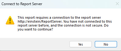

Here’s your problem :slight_smile:
2025-02-26_1-43-32
Not really , but I thought the server name was funny, and this was just opening the default version of the subreport.
Einstein, Really :slight_smile:
I’ve seen that in multiple cloud environments. There’s another one that comes up too, can’t remember the name of it.
