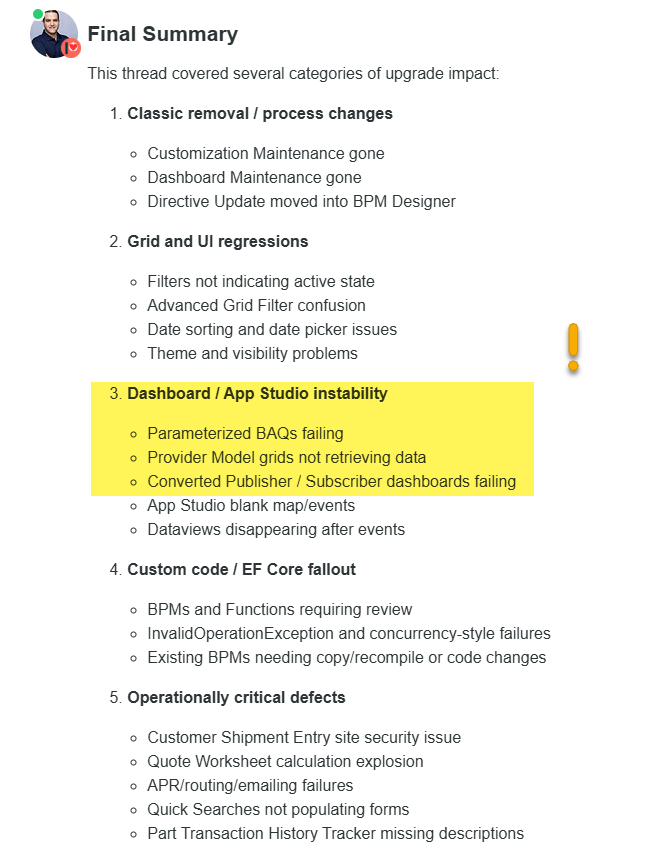

Does anyone know if the dashboard BAQ pub/sub issues will be fixed before the Live update (this weekend)? This is a pretty big deal for us. We have a bunch of dashboards that have parent-child grids that will not work (and currently do not work in Pilot).
From Jose’s summary thread: (thank you Jose by the way)
I created a ticket back on 06/18 but it hasn’t even been assigned to anyone. I’ve replied to the ticket on 06/25 but still have not heard back from anyone yet.
I think its safe to assume this will not be resolved by the 2026.1 version update so I’ve started the long process of rebuilding all of our Pub/Sub dashboards in Application Studio.
I think we have 15+ and I’ve gotten half of them done. The only one I’m having an issue with is where the subscriber has to be an updatable dashboard. No issues with the publisher being updatable if you use the wizard. Hoping to get them all finished before the end of the week.

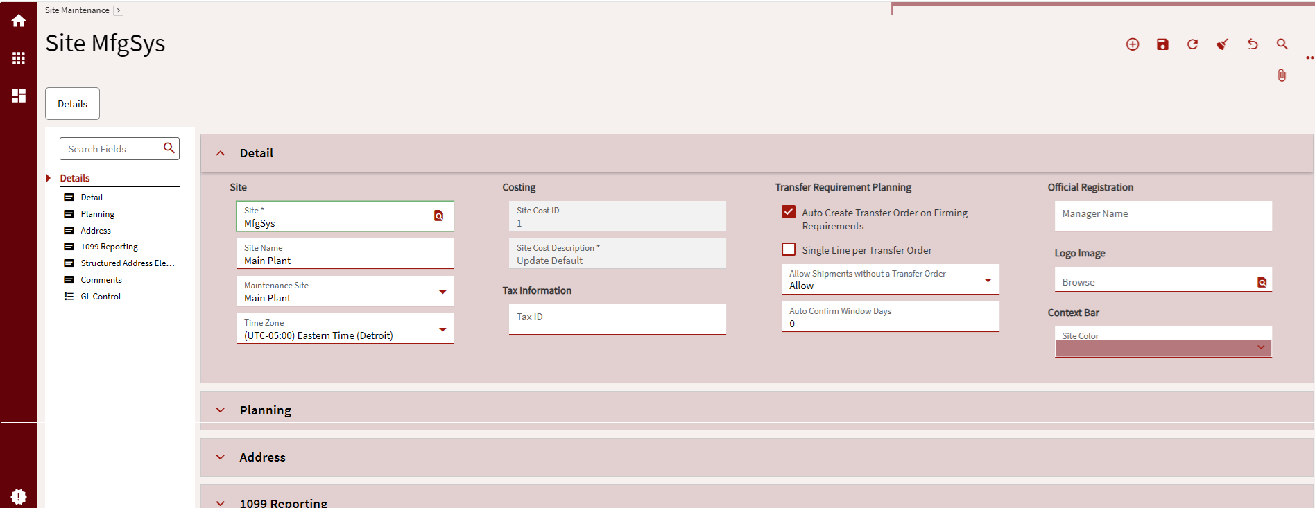

Anyone know if the color theme will still be red in the Live environment after the upgrade??? Or was that just for pilot…front line employees love change
The colors can be changed in Site Maintenance. There was more info about this on another post. We kept the red in Pilot so it stands out for testing.
