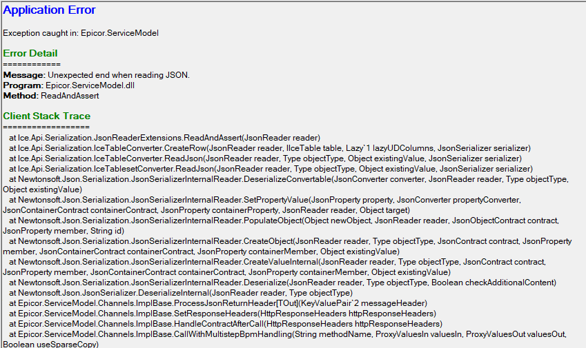

Got a weird one. I’m simply querying the Db and adding our customers to a list to iterate through, yet when I try to display an info message in the loop I get the following error:
I’ve done this many times before and have never seen this error. Here is the code…super simple.

I commented out the rest of the code where I was trying to display my JSON and restsharp response code. It seems like that info could be cached?

And it appears my previous data was cached, I think I read somewhere that infomessage data is stored in callcontext :thinking:
Closing and reopening the client resolved the issue.
