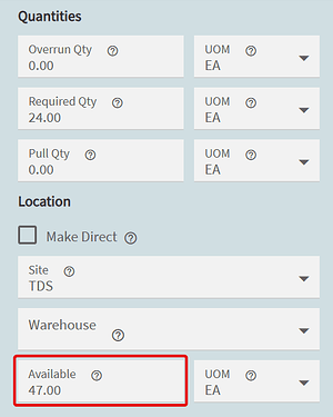

Can anyone tell me how this ‘Available’ quantity field is calculated? Normally I think of Available as OnHand - Allocated. I think that is how it is treated in Part Advisor, for example.
For one of our jobs, on the Job Assembly screen, the Available Qty (47) is showing a value much larger than our On-Hand Qty (11).
We are making 36 of this same part on another job, but it is a Job-to-Job, there is no inventory involved. The fact that the quantity matches exactly indicates this might be the problem.
Job Entry (Assembly)
Part Advisor
So I’m wondering if there is something I am missing, or if there is a bug in this calculation?
I will create a case in EpicCare, but thought I’d reach out here first.
Is there available qty in another site? (Are you multi-site?)
We are not multi-site. Good thought.

I still think the number is incorrect, but maybe there’s an explanation in Time Phase somewhere.
