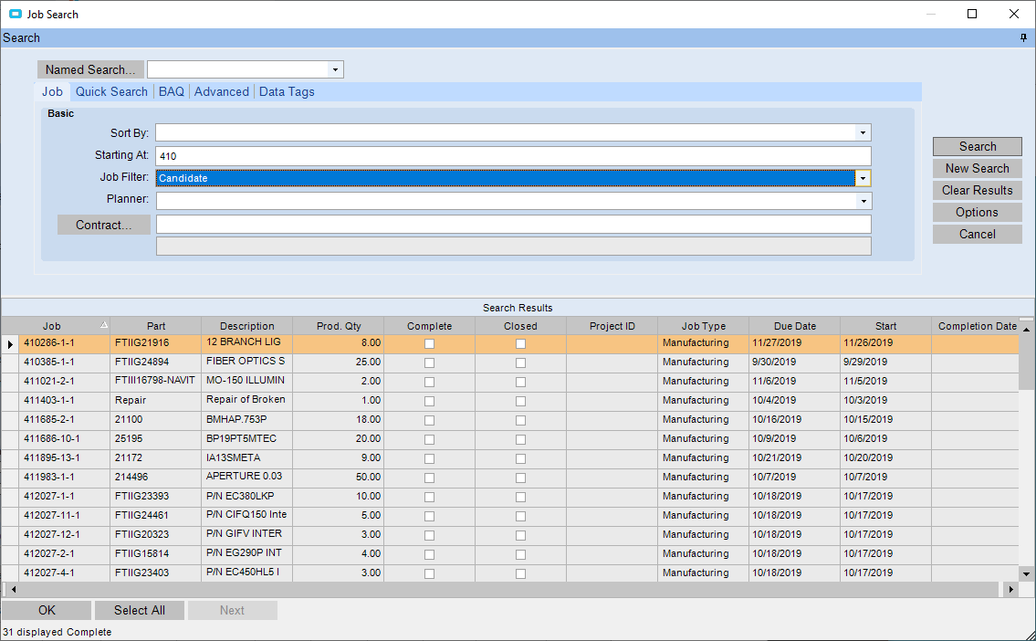

I wish this topic had more info in it since we are having jobs show up as Candidates with only 2 of the 5 operations complete, the final op has no labor on it and there is no completed qty listed on the job closing screens. What on earth would be causing this to happen? I started a call with Epicor but I’m not holding my breath.
We don’t have auto job completion and closing running right now so there are no logs to review. We manually complete and close out jobs. The problem I’m having is they review their Candidates for completion and this is visible when searching for a Candidate and the question is why? It is currently far from being a Candidate for completion.

Sorry no answer for you, just confirming the same behavior when I search jobs with the candidate filter.

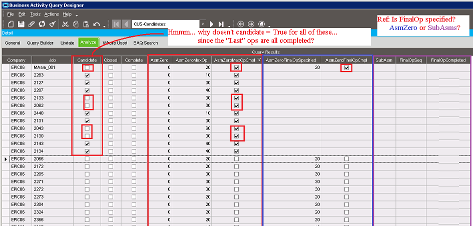

To add to the confusion, not sure how/when JobHead.Candidate gets set either.
Ref screen shot of a BAQ where I tried comparing OpComplete(s) and the Candidate field.

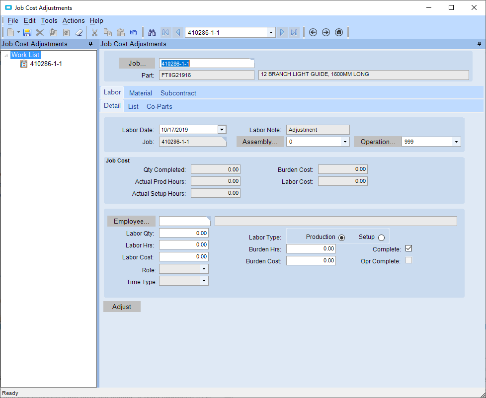

That date is always present, it shows the current date so if you were to check off the Complete box it would enter in that date, that is normal operation of the closing screen. I have found that in the Job Cost Adjusment screen the 999 operation is flagged as complete but there is absolutely no labor posted against it, and I can’t uncheck that box because it will error out stating “A valid employee ID is required”
