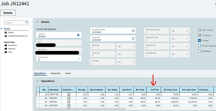

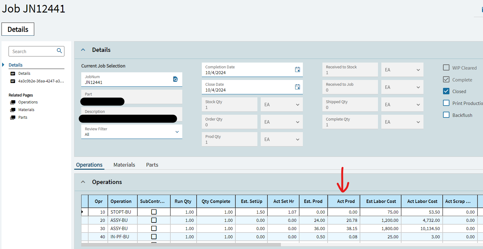

Hi,
When reviewing Actual Hours in the Job Closing screen, we have noticed that the hours are not correct.

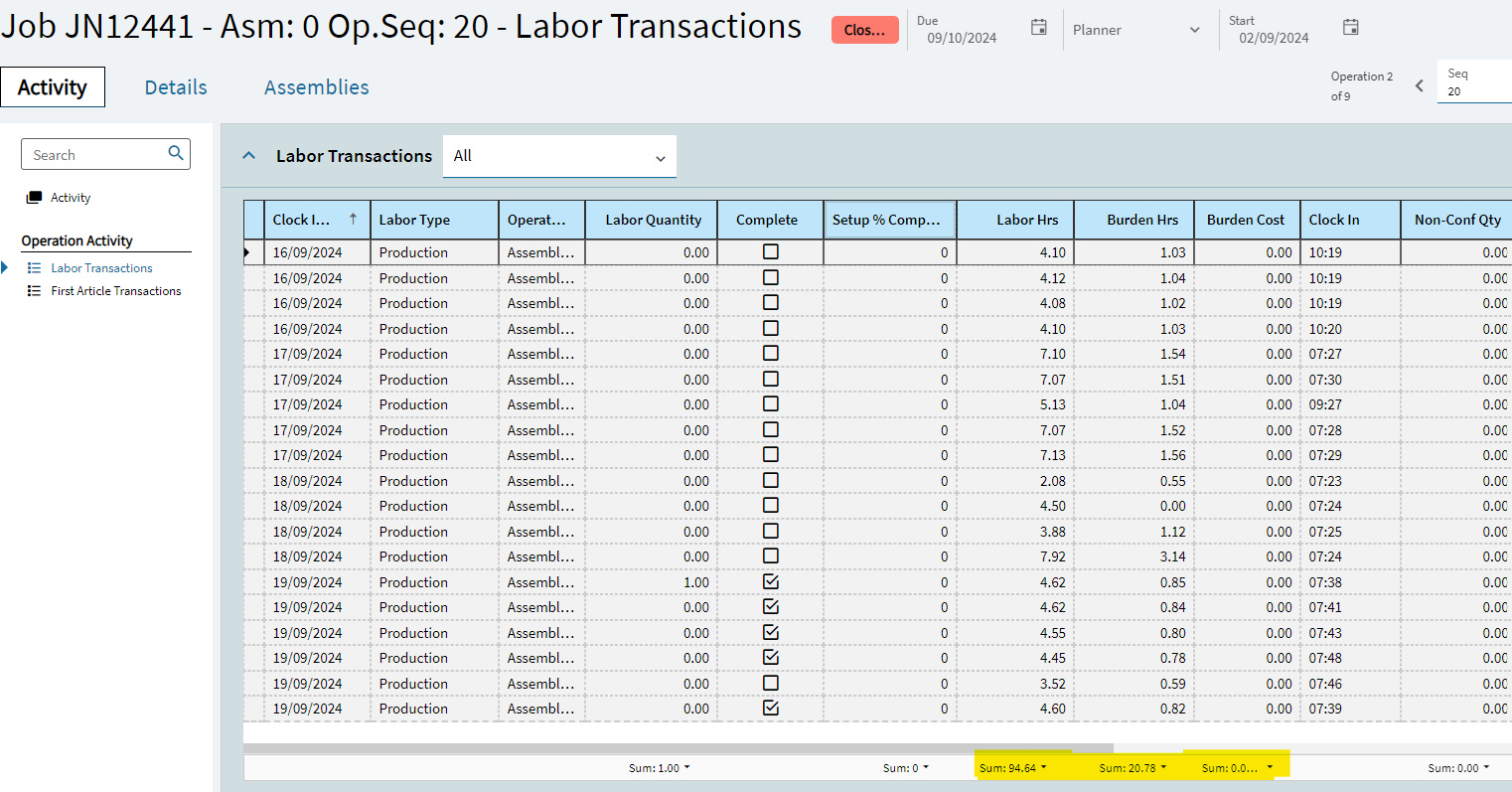

For example below, Op 20 shows 20.78 hours. However, when I review Job Tracker > Activity > Labour Transactions for this op:
  • Total Labour hours = 94.64
  • Total burden hours = 20.78
What could be causing the system to be capturing only burden hours and not labour?
Thanks for any help.

Strangely, the Actual Cost value in Job Closing is correct - i.e. it’s
  • [Prod Labour Rate] x 94.68 Labour Hours

As I say, the ‘Total Act Cost’ is correct, which means the labour rate must be set correctly. What is showing incorrectly is Total Actual Hours.
I’ve checked in Job Entry/Tracker and Job Closing. All three screens show correct costs but incorrect hours.

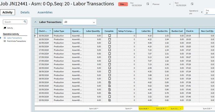

It looks like the Production Detail hours is also showing the burden hours in place of the Total Production Hours. It is showing 20.78 instead of 94.64.
Below shows the labour transactions against this operation and the column totals for Labour Hrs and Burden Hrs:
I’m not clear on why it actually captures burden hours / how it is calculating these hours. We don’t have burden rates set in the system and do not actively record burden hours when clocking onto operations.
The reason for the difference between burden and labor is that multiple people are clocking into the same operation. If you look at the top four labor transactions in your image, they add up to four hours for burden and each one of labor entries is four hours.
If the burden and labor hours should be the same change it on the resource group setting to Burden=Labor.
