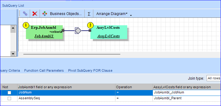

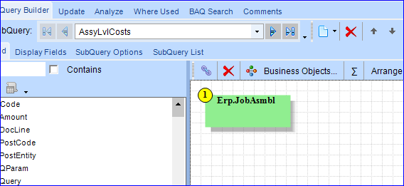

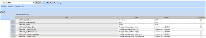

I start with a simply CTE query where I just add the JobAsmbl table.
And I just pull in the display fields so I can have access to all the TLA costs (This level assembly) for each assembly seq.
~~ SECOND QUERY ~~

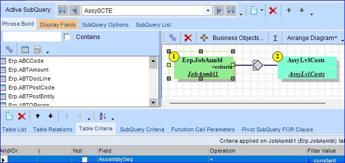

I then create a second CTE Query. In this one, I again pull in JobAsmbl, but then I link it to the first CTE query.
Here, on the JobAsmbl1 table, I need to set AssemblySeq = 0
You’ll link these two tables where Job = Job.
And where the AssemblySeq from the JobAsmbl1 table = the Parent of the added subquery.

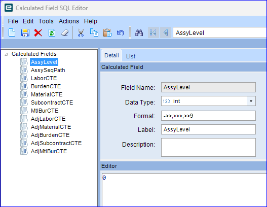

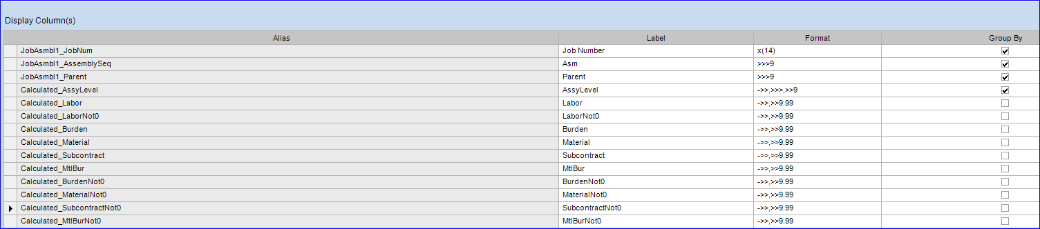

Here are my display fields:
The crux of this step is to lay down you baseline “AssyLevel”… i just use (0):

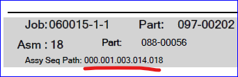

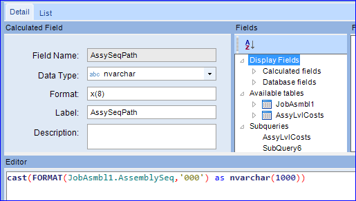

This one, you don’t have to do… but I build an assembly sequence “path” (string), which gets added to as the recursion goes. I can then drop that into reports if I want to.
For example, in my Production Detail report, I’ll end up with something like this, showing an assemblies parentage:
I can easily know that this assembly 18 is part of Asmbl 14, which is in Asmbl 3, which is in Asmbl 1, which is in Asmbl 0.
Again, not required, but its nice to have in your back pocket if you want it later.

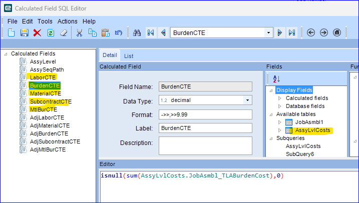

The other calculated fields are SUMs of the values from the first query (AssyLvlCosts, is what I named that one). Because of the table relationships, these will sum, for example, the labor costs of all assemblies where Assembly 0 is the parent.
I will generally add the ISNULL statement in each one so I end up with zeros going forward and not null values.
Once, you start adding these SUM aggregate calculated columns, you’ll have to add the other columns to the group-by clause (see snip of display columns above).

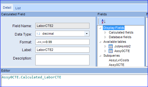

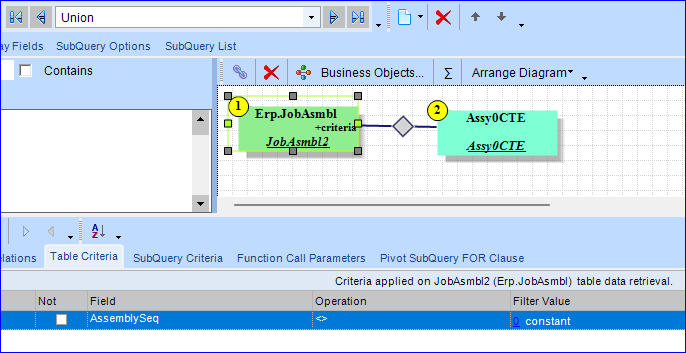

~~ THIRD QUERY ~~
This is your Union All… and it looks just like the last query.
Pull in JobAsmbl (again)… and then pull in the second query you just created.
In this case, The AssemblySeq from the JobAsmbl table <> 0.

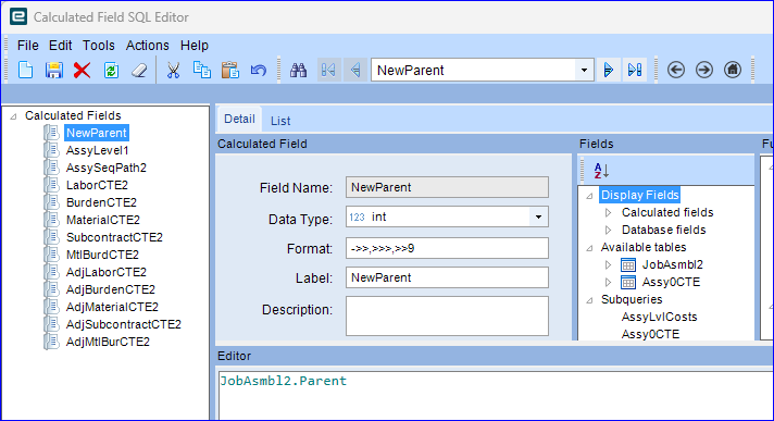

And, I flip the relationship so the Parent of the JobAsmbl table is the AssemblySeq of the Assy0CTE query (the second query).
Here are my display fields. A Union query MUST have the same number of fields as the previous query, AND each column must be the same data type as the previous query.
Here are the calculated fields:

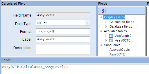

NewParent: As the query recursively runs, you want to update the parent of the assembly.
AssyLevel1: You are going to take the AssyLevel from the previous query and add 1.
AssySeqPath2 (if you’re choosing to do this): You’re just appending the previous path with the current assembly number as it recursively moves forward.
All the other calculated fields, I’m just pulling in the fields from the original CTE query.
This may not have to be calculated fields, but I created them that way because I wasn’t sure if it was going to have to add the ISNULL statement again.

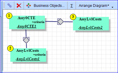

To start, make this a Top Level query so you can start testing and seeing results.
I brought in my Assy0CTE, and then I brought in the AssyLvlCosts (the very first query) twice.
For Table (3) in the above snip, I set that join where AssemblySeq = AssemblySeq (so, this will pull in all my Assembly 0 top level values).
For Table (2) (the one on the bottom), I set that join where AssemblySeq = Parent
Also have a table criteria on that one where AssemblySeq <> 0
Here are my display columns:
The first few are pulled in from the Assy0CTE query, and we’ll group on those. That gives you each asssemblyseq on the job, its parent, and the assembly level.
Just run a quick test on that. See if you get all the assemblies on the job to appear, AND that the correct parents are assigned, and you should see the assembly levels incrementing up.
If so, then recursion is working… and you can start creating more calculated fields to sum all the other stuff you need. I did a horrible job naming mine. But my “Labor” should be equivalent to “TLA Labor” and my “LaborNot0” should be equivalent to “LLA Labor”.

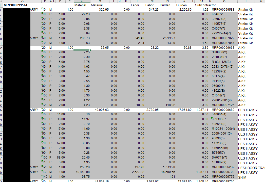

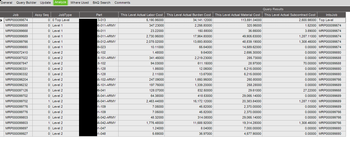

That got me closer :slight_smile: using a bunch of unions I can get the information for each level. I have to add a query for each drill down though since I still don’t understand how to make it recursive… I have a handmade spreadsheet that I am trying to reproduce in the BAQ.
What I can get
What I’m trying to get
part, Mtl Seq, Part Type, Costing, Lot
