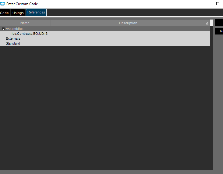

Here’s my code:
> //References
> Erp.Tables.ShipHead ShipHead;
> Ice.Tables.UD13 UD13;
> foreach (var ttJobHeadrow in ttJobHead.Where(ttJobHead_Row=>ttJobHead_Row.Deleted()))
> //Setting up variables you will need to add a record to the DB
> UD13Impl ud13BO = WCFServiceSupport.CreateImpl<UD13Impl>(FormFunctions.getILaunchSession(oTrans), UD13Impl.UriPath);
> UD13DataSet tempSet = new UD13DataSet();
> //Get new UD Record and set it to the tempSet
> ud13BO.GetaNewUD13(tempSet);
> //fill in your tempSet with the data you want
> tempSet.Tables[0].Rows[0]["Key1"] = ttJobHeadrow.JobNum;
> tempSet.Tables[0].Rows[0]["Key2"] = ttJobHeadrow.ChangeDate;
> tempSet.Tables[0].Rows[0]["Key3"] = callContextClient.CurrentUserId;
> //Update the database with your new record
> ud13BO.Update(tempSet);
Here are the errors:
> Details:
> Error CS0246: The type or namespace name 'UD13Impl' could not be found (are you missing a using directive or an assembly reference?) [Update.Pre.JobDeletionTrack.cs(136,3)]
> Error CS0103: The name 'WCFServiceSupport' does not exist in the current context [Update.Pre.JobDeletionTrack.cs(136,21)]
> Error CS0246: The type or namespace name 'UD13Impl' could not be found (are you missing a using directive or an assembly reference?) [Update.Pre.JobDeletionTrack.cs(136,50)]
> Error CS0103: The name 'FormFunctions' does not exist in the current context [Update.Pre.JobDeletionTrack.cs(136,60)]
> Error CS0103: The name 'oTrans' does not exist in the current context [Update.Pre.JobDeletionTrack.cs(136,92)]
> Error CS0103: The name 'UD13Impl' does not exist in the current context [Update.Pre.JobDeletionTrack.cs(136,101)]
> Error CS0246: The type or namespace name 'UD13DataSet' could not be found (are you missing a using directive or an assembly reference?) [Update.Pre.JobDeletionTrack.cs(137,3)]
> Error CS0246: The type or namespace name 'UD13DataSet' could not be found (are you missing a using directive or an assembly reference?) [Update.Pre.JobDeletionTrack.cs(137,29)]
> Error CS1061: 'Erp.Tablesets.JobHeadRow' does not contain a definition for 'ChangeDate' and no extension method 'ChangeDate' accepting a first argument of type 'Erp.Tablesets.JobHeadRow' could be found (are you missing a using directive or an assembly reference?) [Update.Pre.JobDeletionTrack.cs(144,53)]
Here are my references too:
 ![image](https://www.epiusers.help/uploads/default/original/2X/0/06778f6f8f117ac038aabb9b7d5a08308a92f4dc.png)
Do I need to add more references or something?
